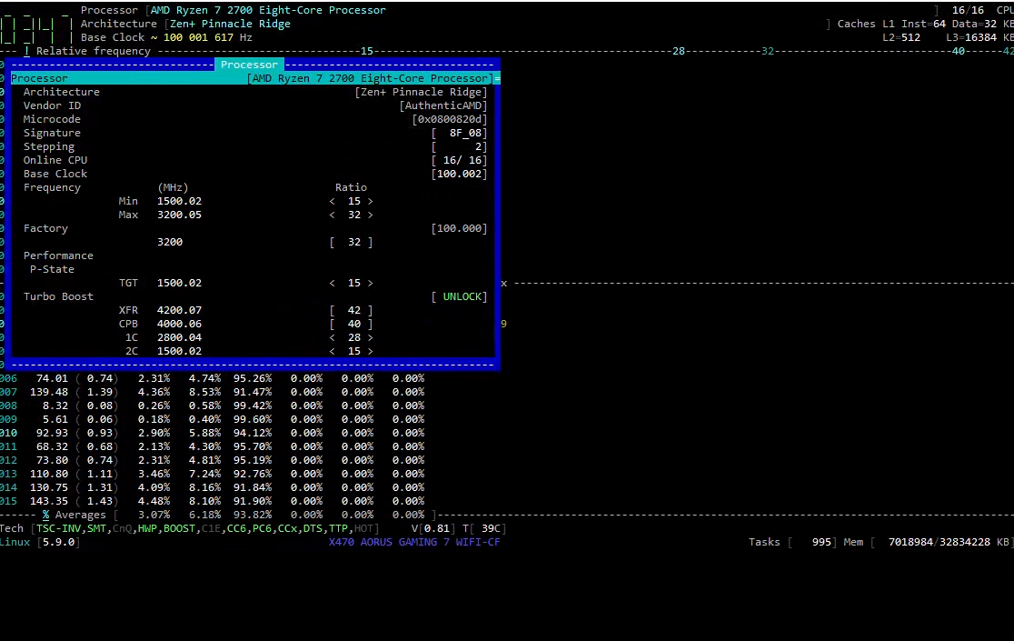

    5.9RC8-20201005   update to 5.9RC8 updated paragon ntfs3 v7 updated dax virtio improvements update iommu amd improvements to pcie aer  nvidia driver Persistence mode enabled at boo

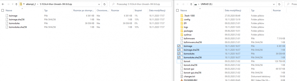

you have 4 files in the archive.... bzimage, bzimage.sha256, bzmodules, bzmodules.sha256
you have the same 4 files on the unraid flash drive....
just move those files into a different folder if you ever want to undo the install and copy the 4 files that are in the zip into the root of the flash driver
and reboot that's it....

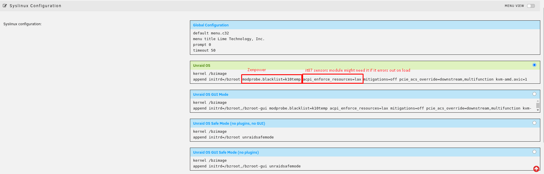

don't forget to add modprobe.blacklist=k10temp to syslinux config into syslinux config  on the flash drive

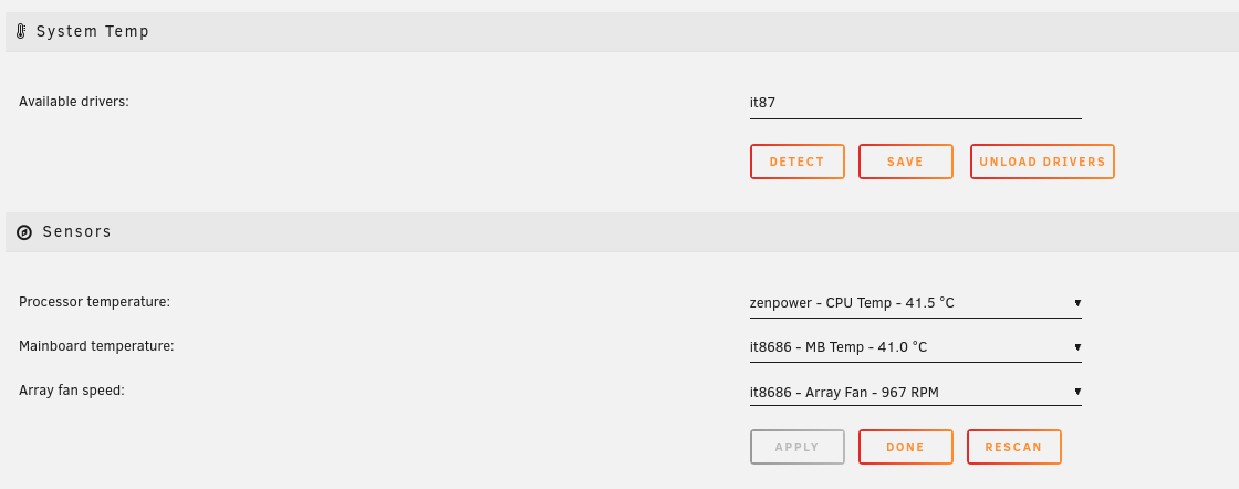

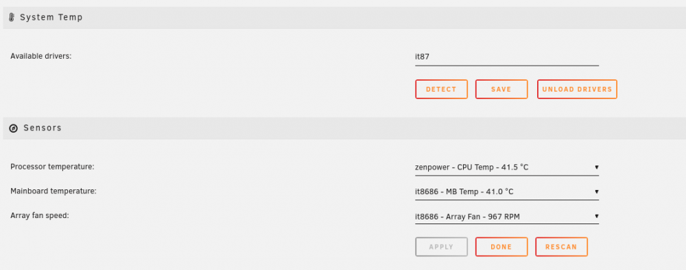

depending on the motherboard sensors chip you might need to load it87 module
you can use the Dynamix System Temp plugin to load the it87 modules every boot and how temps you have a picture of mine below
you can check with command sensors whats detected...

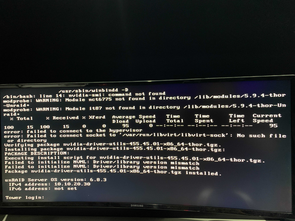

I was able to boot without modprobe.blacklist=k10temp,acpi_enforce_resources=lax. If I add them to syslinux.cfg, I received the following error during boot (attached screenshot).
Any ideas?
I see you used "," between them you need to use space
Like this "initrd=/bzroot modprobe.blacklist=k10temp acpi_enforce_resources=lax"
Ha. n00b mistake. Thanks bud for the quick response and guidance.

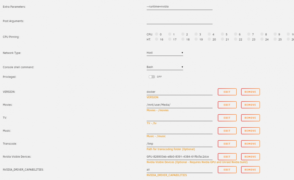

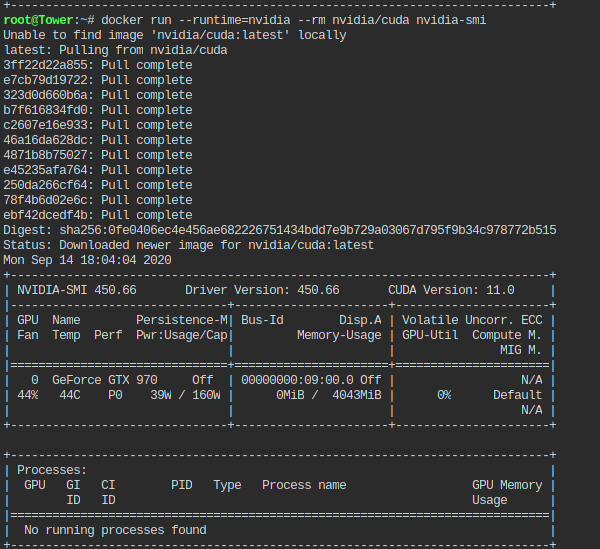

added nvidia driver 450.66(requires utils to function properly) includes nvidia docker and all requirements
added zfs utils
IMPORTAT NOTICE:
*) utils need to be installed at boot I do it with the /boot/config/go file and placed the downloaded utils packages in a packages folder on root of the usb drive after that add "installpkg /boot/packages/*.tgz" in the go file first after "#!/bin/bash" in a new line
*) dont try to install the utils packages on any modified rootfs .... they need to be installed on stock unraid rootfs1706364532_Screenshotfrom2020-09-1421-08-26.png.f952b22c2a94bf036fc60bab0bbd2af2.png

updated corefreq kernel module(added utils for corefreq module run corefreq-cli-run)
updated paragon ntfs3 v5
corefreq-cli app
