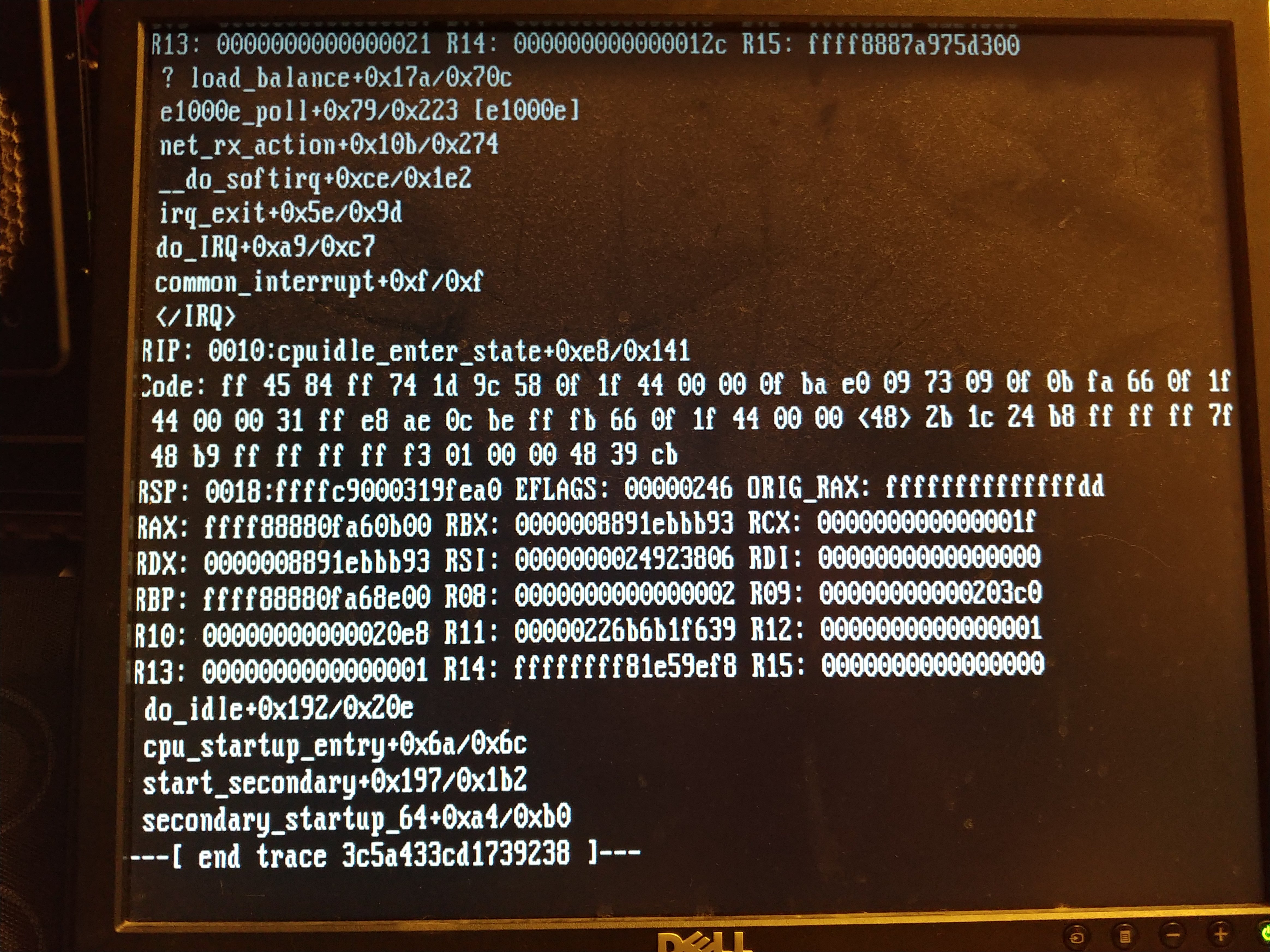

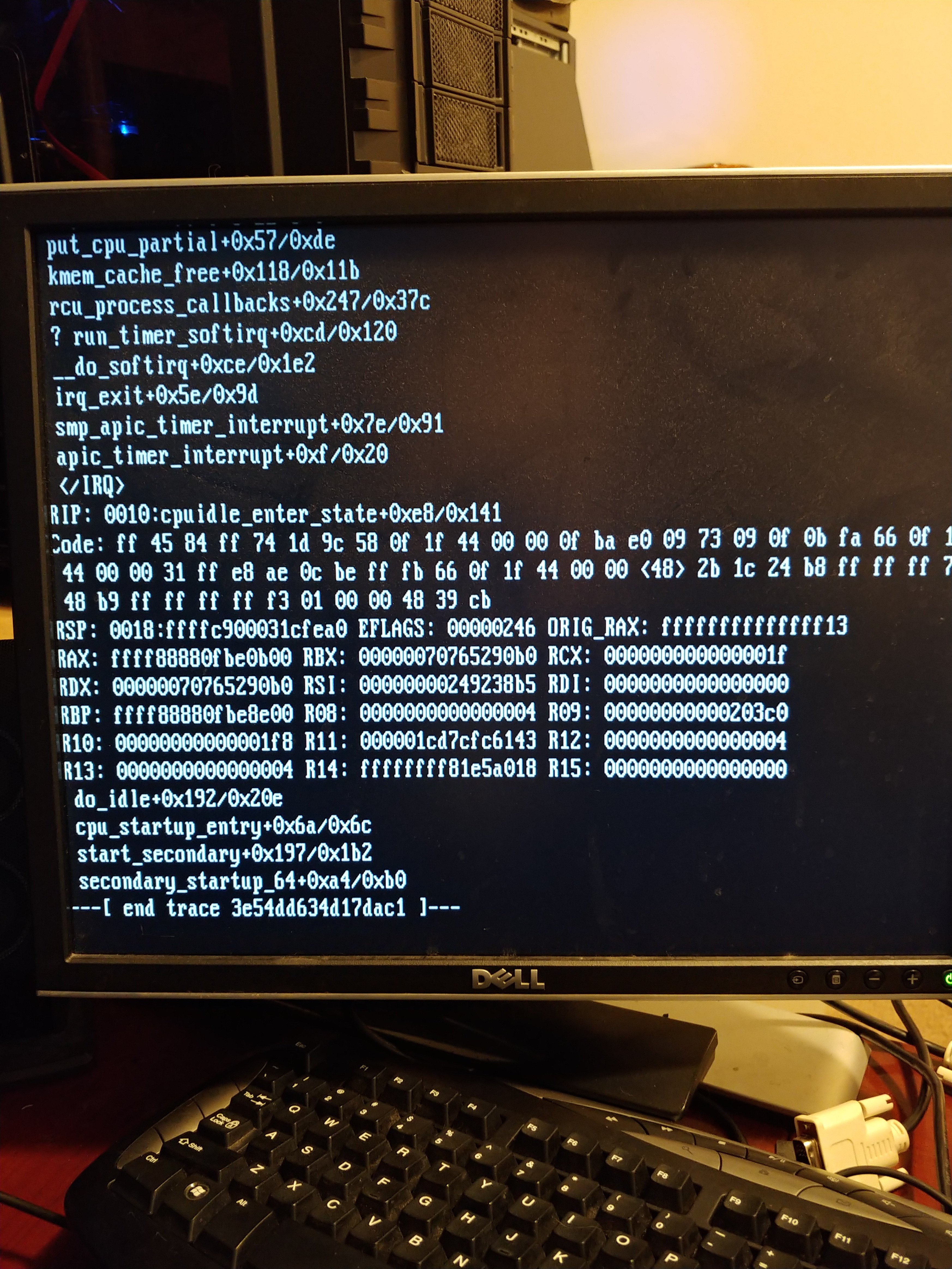

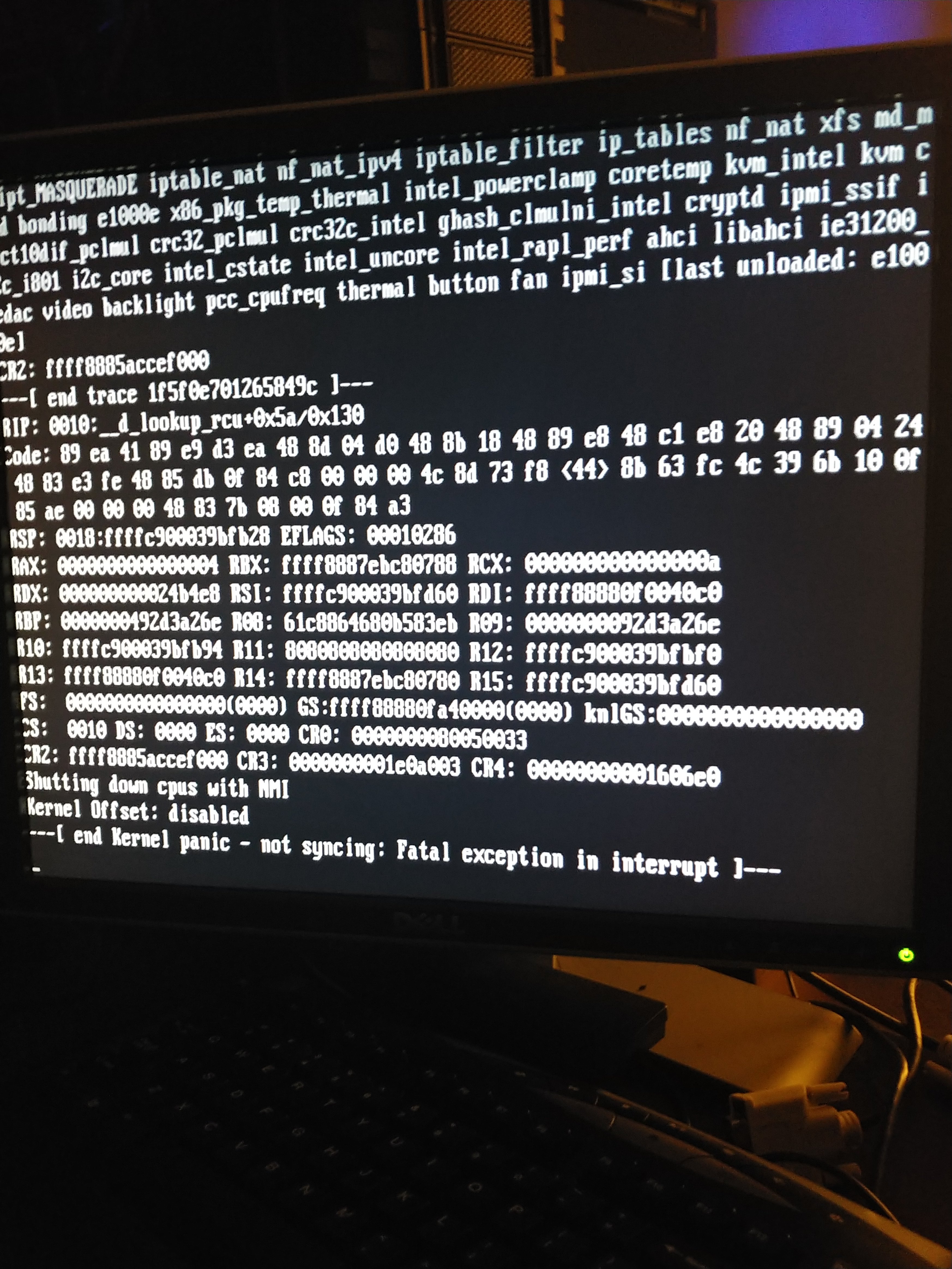

My server has been crashing and I would appreciate help with diagnosing it. I've noticed it crashes more often during copying, or working with docker containers. So I replaced the sata cables (brand new) and it let me copy TBs of files with no issues. The next day it crashed again. Sometimes it just straight up randomly hard reboots, no stacktrace, no error nothing. Most of the time when I go to check on it, there is a stack trace on the screen, but never any errors in the log at the time of the crash.

I tried mirroring the syslog to flash, and even through several crashes, nothing is captured in the log at the time of the crash..

Alright, I set up a syslog server on another pc, The server did a hard reset on its own, just crashed and rebooted, no stack trace, no errors. Nothing in the syslog near the time. Reset at 11:24, last entry from 11:07 and its just info nothing helpful. Any advice on how to track down whats causing this?
