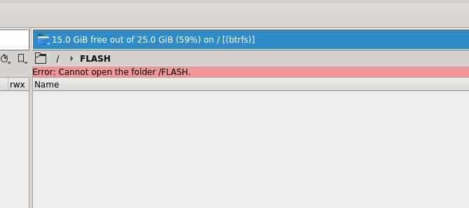

Flash drive not accesible?
Ive gone through about three different flash drives and none of them have been accesible using Krusader.  At this point I am heavily betting against myself and thinking user error.
Any help would be appreciated.  Thanks!

If everything else is working it is much more likely that you just don't have Krusader configured correctly. Post your docker run command as explained in the very first link in the Docker FAQ.
root@localhost:# /usr/local/emhttp/plugins/dynamix.docker.manager/scripts/docker run -d --name='binhex-krusader' --net='bridge' --log-opt max-size='50m' --log-opt max-file='1' --privileged=true -e TZ="America/New_York" -e HOST_OS="Unraid" -e 'TEMP_FOLDER'='/config/krusader/tmp' -e 'WEBPAGE_TITLE'='UNRAID' -e 'VNC_PASSWORD'='' -e 'UMASK'='000' -e 'PUID'='99' -e 'PGID'='100' -p '6080:6080/tcp' -v '/mnt/user':'/media':'rw' -v '/mnt/':'/ALLDRIVES':'rw,slave' -v '/boot/':'/FLASH':'rw' -v '/mnt/user/appdata/binhex-krusader':'/config':'rw' 'binhex/arch-krusader'
8bc2d5987ba5fce1a37db18fd280eb8f7d6f2442a0c24e035f277ad34f5f7366
The command finished successfully!
Sorry here it is.
That docker run looks like it should give you access to flash in Krusader. So is everything else really working OK, or has your flash drive disappeared?
Go to Tools - Diagnostics and attach the complete diagnostics zip file to your NEXT post.
Sorry for the late reply.  That fixed it.  Thank you!
