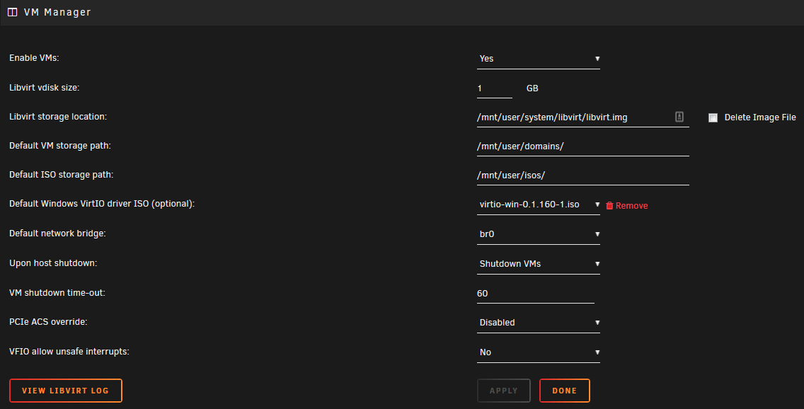

After powered cycle my Unraid server, all the VMs are gone from the Dashboard and VMs tab. When I navigated to Settings --> VM Manager, it only showed the blank page. Tried to reboot the Unraid server multiple times but fixed nothing. Please check below for my screenshots and attachment of the diagnostics file.

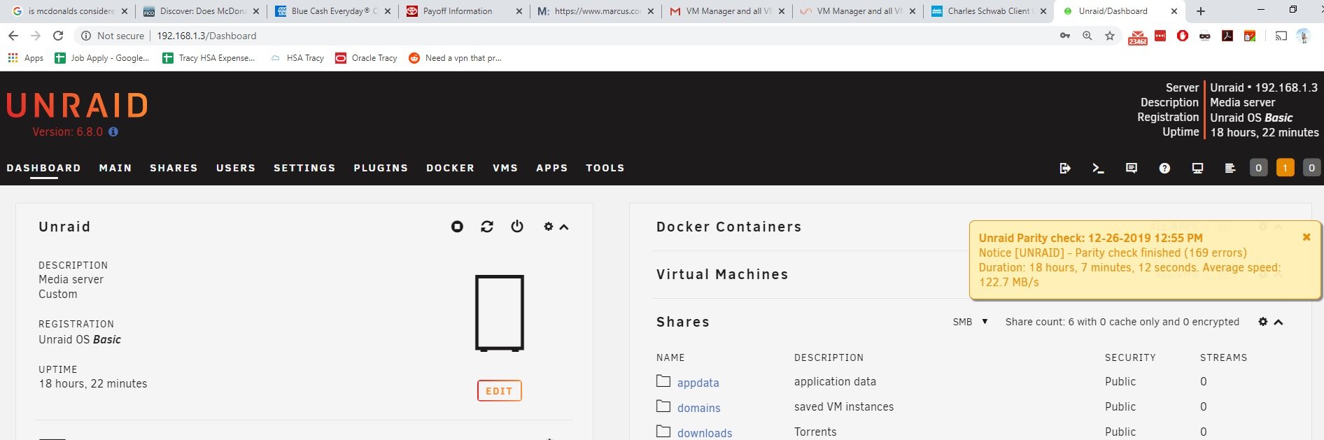

I notice you are correcting a lot of parity errors? Is that expected? Have you done memtest?
It's expected. Parity checks automatically occurred when I rebooted the Unraid server. Memtest runs just fine.
The issue started happening when I assigned the onboard GPU which was using by Unraid GUI to one of the VM. After the restart, all VMs / VM tab were gone. Please advise.
Libvirt.img is mounting correctly, if it's empty there could be another one, post the output of
find /mnt -name libvirt.img
Please check below for the output. Note that the libvirt.img in "backup" folder was created by me after the issue happened just in case.
root@Unraid:~# find /mnt -name libvirt.img
/mnt/user/system/libvirt/libvirt.img
/mnt/user/downloads/backup/libvirt.img
/mnt/user0/downloads/backup/libvirt.img
/mnt/cache/system/libvirt/libvirt.img
/mnt/disk1/downloads/backup/libvirt.img
Edited by baonguyen312
So the backup was done after the current problem? Current libvirt.img is empty, so unless you have a backup of an older image you'll need to recreate the VMs, you can still use the old vdisks if you point to them when recreating the VMs, at least with most of them.

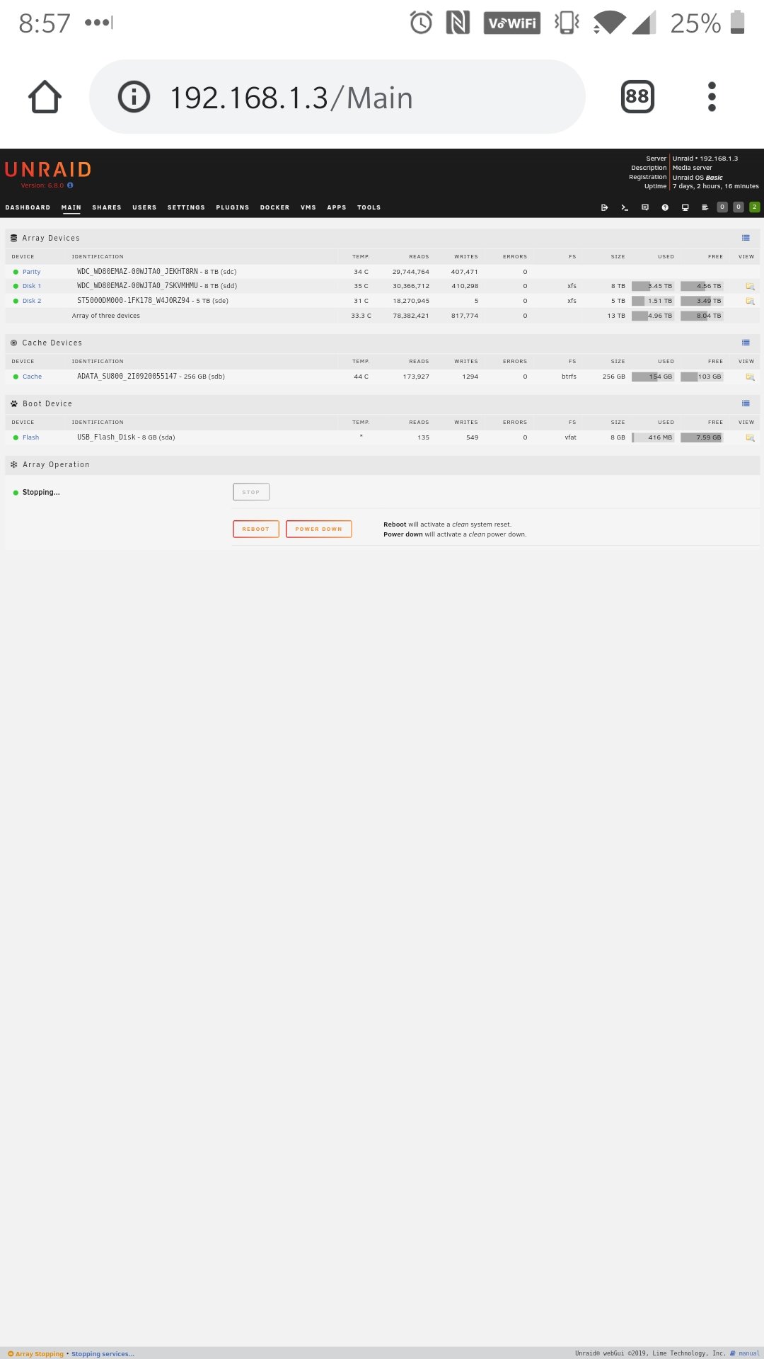

This has been driving me crazy. I'm not able to stop the array at all. Once I clicked on "Stop" the array, it just stuck at "Stopping" forever and the array was still up and running.
Resetting the server would bring the array online again. Please advises.
This means there are other problems, you'll need to fix that first, Unraid should save diags to the flash drive if it fails to cleanly shutdown after some time, default is 60secs, those might give a clue to the problem.
