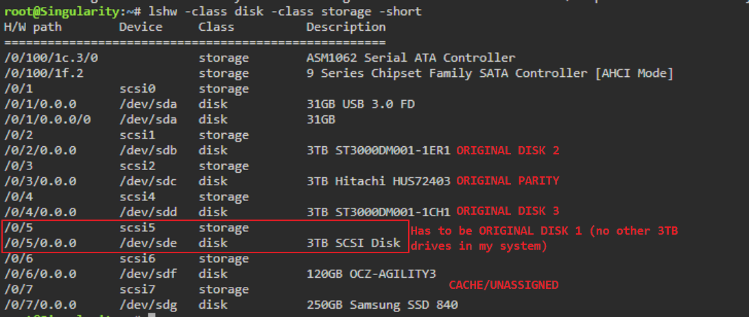

I needed to shrink my array due to wanting to remove a bad drive, but don't have another driver for its place. I followed the steps outlined here:  https://wiki.unraid.net/Shrink_array#The_.22Remove_Drives_Then_Rebuild_Parity.22_Method
First HUGE mistake, and Im still hating myself every minute for this.  But I took a screenshot of the array, and then saved said screenshot on my array.  Honestly, how idiotic of me.  Anyhow, I got to the step of starting the array and it wouldnt start because for some reason it said my GUID was blacklisted.  I debated for sometime, but ultimately ended up deciding to reboot.  Unraid came back up and now wants me to assign devices.
I know the Hitachi is my parity drive, 100% sure.
The Samsung is my is either my cache drive or my unassigned device.  80% sure its my cache drive
The ancient OCZ is an unassigned device for a VM, or my cache drive.  80% sure its an unassigned device.
This leaves sdd and sdb.  I believe the drive that failed no longer appears here.  Disk 1 was the failed disk.
My problem statement is that I am not sure if sdd was Disk 2 or 3.  Thus, I dont know if sdb is disk 3 or 2.
Is there a way to still retain my data?

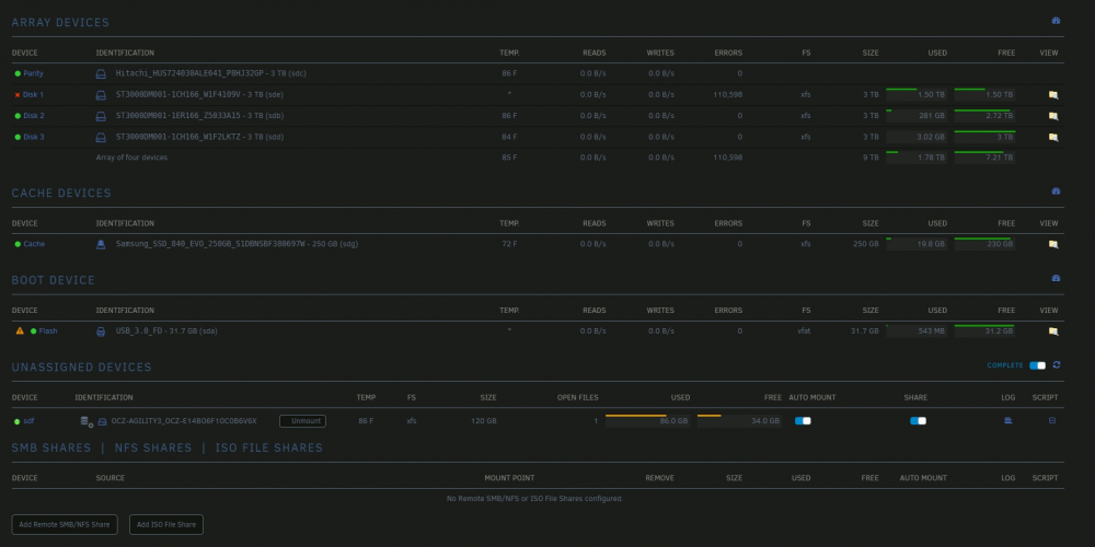

Edit:  I was able to mount sdb and get my array image.
However, when I put the disks in those assignments, I get a warning on my Parity that All existing data on this device will be OVERWRITTEN when array is Started
Is that because disk 1 is missing now?  Will unraid rebuild parity and take the data that is missing from Disk 1 and rewrite it to Disks 2 and 3?

1. sd? assignments are not to be used for slot identification. They can and will change. You must use drive serial number to assign the drives.

1.  Yes I know drive serial numbers are how you set drives, I was only using linux naming to point out the drives and not type out entire serial number :)

  1. As mentioned, the sd designations can and will change. They will especially change when disks are added, replaced, or removed. They can even change from one boot to the next for no apparent reason. So they are not useful for understanding how disks were previously assigned.
  2. If the disk was missing or disabled, its contents should have been available anyway from the parity calculation. This is known as "emulation". It is even possible to write to an emulated disk, parity is updated as if the disk were written, and so the written data can be recovered when the disk is rebuilt.
  3. It will, but it requires parity plus all of the other disks to calculate the contents of the missing disk. Parity disk by itself cannot recover anything.
  4. There is a command line method to tell Unraid to rebuild a disk other than the parity disk during New Config. You need a disk to rebuild to.

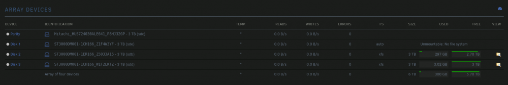

When you have a new disk you can use the invalid slot command.
-Tools -> New Config -> Retain current configuration: All -> Apply (you can skip this step if already did a new config)
-Assign any missing disk(s), including the new disk1
-Important - After checking the assignments leave the browser on that page, the "Main" page.
-Open an SSH session/use the console and type (don't copy/paste directly from the forum, as sometimes it can insert extra characters):
mdcmd set invalidslot 1 29
-Back on the GUI and without refreshing the page, just start the array, do not check the "parity is already valid" box (GUI will still show that data on parity disk(s) will be overwritten, this is normal as it doesn't account for the invalid slot command, but they won't be as long as the procedure was correctly done), disk1 will start rebuilding, disk should mount immediately but if it's unmountable don't format, wait for the rebuild to finish and then run a filesystem check
Edit:  Nevermind, I am dumb.  Just re-read your statement:
During filesystem/parity check, do I want to Write corrections to parity this time?

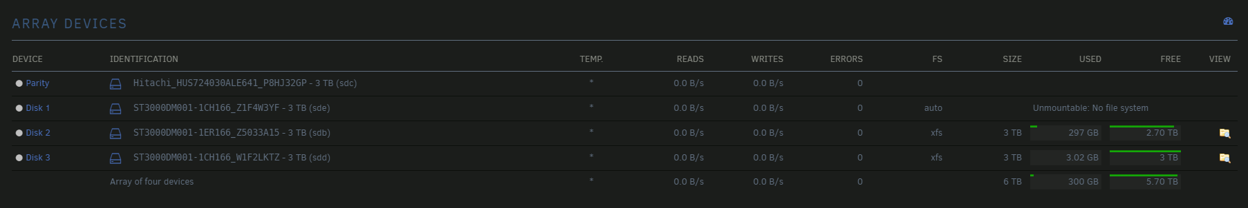

Ok, followed the steps above, thank you again.  Parity rebuilt and now I have:
Do I want to format to create file system?
Edit (follow up):  Why does the parity drive not show usage stats?  Is it because they are all spun down?
Edited by Singularity42

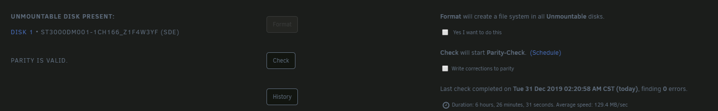

No, please post current diags, there might be some filesystem corruption because of this:
On 12/27/2019 at 7:56 AM, johnnie.black said:
This was hopefully mounted read only, though xfs can usually survive even if it wasn't, but can cause some filesystem corruption on the rebuilt disk.
Hopefully it's fixable.
