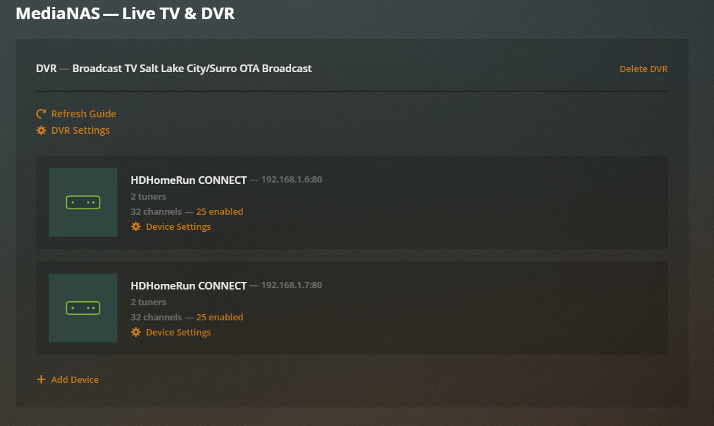

1 hour ago, Arbadacarba said:
Does the HDHomeRun work with Unraid/Plex?
Yes, I have two of them working standalone and integrated with Plex.
There is a cable card version, but I use then with OTA antennas only.
The DVB drivers are for DVB-T tuner cards (non-networked tuners).
Is there any guidance available on how best to integrate hdhomerun with Plex ? I assume when you say integrated you mean you use hdhomerun for scheduling recording etc and then push the results over to Plex for them to be accessed via a standard Plex client app .
This is a Plex Pass feature so you have to start with a Plex Pass version.
The HDHomeRun can be used to record OTA shows through Plex and store them in unRAID shares for viewing via any Plex client.  Basically, you are using Plex as the channel guide/DVR for recording and unRAID as the storage instead of the native HDHR DVR/NAS functionality.
You can also watch live TV via Plex.  I have done this several times when traveling as it allows me to watch my local TV from anywhere with an Internet connection.
HDHomeRun devices are setup under the Live TV & DVR section of Plex Settings (be sure you are in Settings)
Add the appropriate devices and enable/assign the channels you want to appear in the schedule and define device settings as you wish.
Your guide for your local market will then be downloaded and you can schedule DVR recordings in the Guide or watch Live TV from Live TV & DVR in the client.
