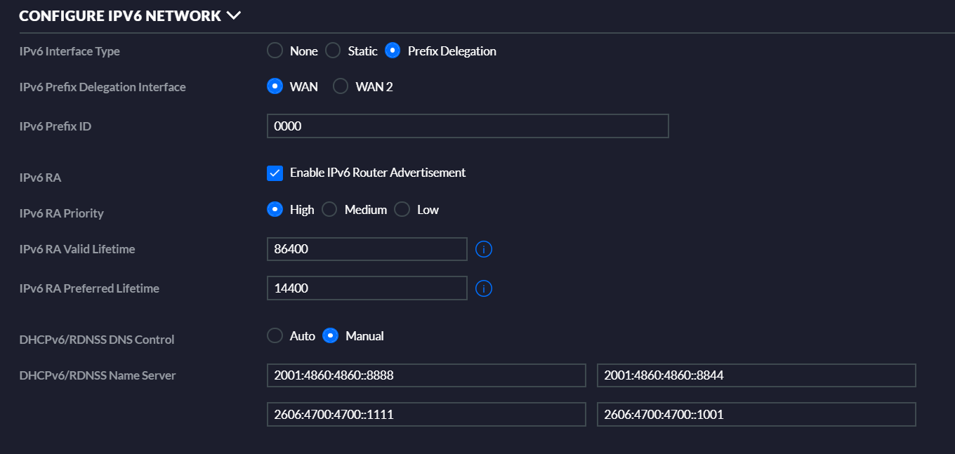

My ISP has given me a /48 subnet (the 2a02: one) and I configured this in my router with DHCPv6 and now it is distributing ipv6 adress using prefix delegation (I don't have a single other option I can change, but ill post that problem in the forums of my router if that is the problem).
All my other devices do work with the ipv6 from dhcp. Is this a limitation in unraid docker settings that the gateway has to be in the same subnet or am I being stupid?

This is because in the LAN interface I have set it to prefix delegation (I can't save it when I choose static but that is a problem for the other forums) and do not have an option for gateway (I assume you have it on static?).

I forgot about this but I recently managed to fix the high cpu usage with ipv6 so I decided to try this again, I wanted to make a ticket in the ubiquiti forums but considering I made a few tickets and all of them took months for a proper reply I decided to ask it here again so I hope you guys can help me.
