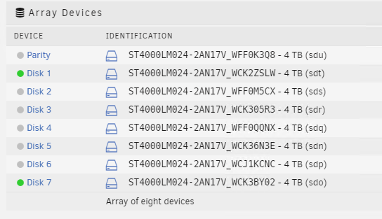

2 minutes ago, Keichi said:
I should receive my LSI controller in a week, and hoped it will work better with it, but i guess i will see.
They work fine with an LSI, at least SAS2 models, should be the same with others, I have 8 of those disks on one 9211-8i
It's fine, as long as it really is genuine, also when you get it check the firmware, some come with older p20 firmwares that are problematic, it should be on p20.00.07.00.
