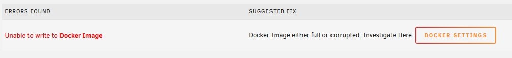

Hi, I noticed this afternoon that my usual dockers weren't running anymore. I tried starting them back up but I get a "execution error" message so I thought maybe updating them would help. When I try updating though I get another message, indicating my that a certain file is read-only. I haven't changed any settings on my server lately so I don't get why this problem just appeared! I didn't get any notifications about something going wrong either.
Fix Common Problems tell me to  investigate the docker settings because there is a issue with my Docker Image but I don't know what I should be looking at on said page. Can anyone help me with this?

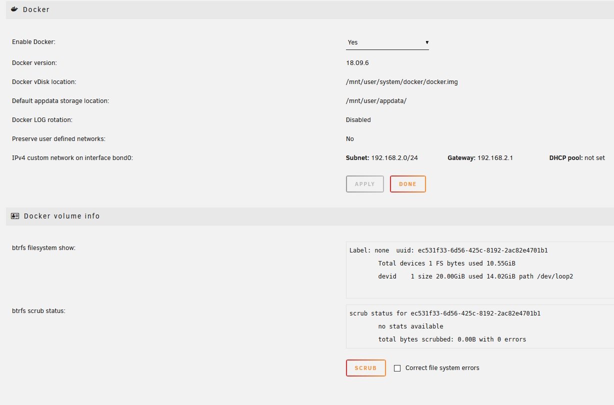

I would venture to say your docker image file is full or corrupted.
Take a look at your docker configs, make sure that nothing is set to log to the docker file instead of to a share. Even though things have been running just fine for a while, if you've got something logging infrequently, but to the wrong place, it would eventually fill the docker.img file.
Someone who actually can interpret the diagnostics will be along soon to see if there's anything more specific, but that should be something to get you started.
The only docker that points to /var/lib/docker in it's config is cadvisor but I can't even remember the last time I had it running or why I installed it tbh. The /var/lib/docker/ is the path for "Host Path 4" but I'm not familiar with what is the purpose.

How do I run a scrub?
On the main GUI page click on cache then scroll down to "Scrub Status" section.
