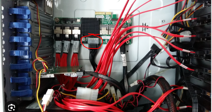

I know I can mount/screw all the 11-20 disks in my second tower, but how do I connect them, so that I can use both tower's disks on 1 unraid motherboard / system?
So how do I connect all those disks to my main unraid tower?
I have a second big tower, and then what do I need more?
Else than the disks and a second psu in the second tower, of course.
Sorry, maybe, for asking this "again", but I still am not finished with this matter of expanding.
I have knowledge about building 1 case, but I don't have the knowledge to expand it beyond 1 case/tower.
Thanks in advance, again,
Rik

So I am looking for a card that gives me at least 10 connections to SATA.
Is something like a Dell PERC H200 giving me that?
Or what PCIe expansion card can I use to get another 10 SATA HDD's connected with my motherboard?
Edit: Something like this? https://www.ebay.com/itm/195577453931

Keep reading. Pretty much any LSI 4e or 8e installed in the primary case with the motherboard will have the appropriate port to connect to the expander that connects to many more drives in the second case.

Take a look at the first post in this thread, the 8 port section.

12 minutes ago, rikdegraaff said:
So for, let's say 20 drives (2 parity and 18 data) I need three 8 port cards?
No, you could use a single 4i/4e card in the motherboard with the expander you linked on ebay in the second case to connect all the drives installed there.

So I already have a Supermicro AOC-SAS2LP-MV8 for the main Tower that I am using (the one that is full now).
Then I buy 1 4e card that I use as a "hub" for the expander on eBay.
After that I put the 4e card in my main tower mobo.
Then I have 4 extra SAS slots in my main tower.
And how do I connect the 4e card and expander together?
If that succeeds then I can use the expander for the 10 or more disks/sata 7pin connections, I am going to put in my second tower?
Am I thinking right?

13 minutes ago, rikdegraaff said:
And how do I connect the 4i card and expander together?
This specific post has the parts.
https://forums.unraid.net/topic/74460-external-sas-storage-101-query-not-guide/?do=findComment&comment=686265
The 4e (not i) port on the card connected to the motherboard goes to the adapter bit to convert from external cable to internal connected to the expander. You could use the 4i port on a 4e/4i card in the main box to connect 4 drives in the main tower. BTW, I think that AOC card is one that gives some people issues, I think it uses a marvell chipset.

4 hours ago, JonathanM said:
could you please give this thread a quick once over and make sure I've not sent rik astray?
That's still a good option, when used with an expander.
10 hours ago, rikdegraaff said:
But one thing, do I need another motherboard and parts in that second tower?
Because I thought that every card was going to have a place on my first motherboard...
Only the expander and drives go in the second tower. The LSI controller goes in the main tower.
