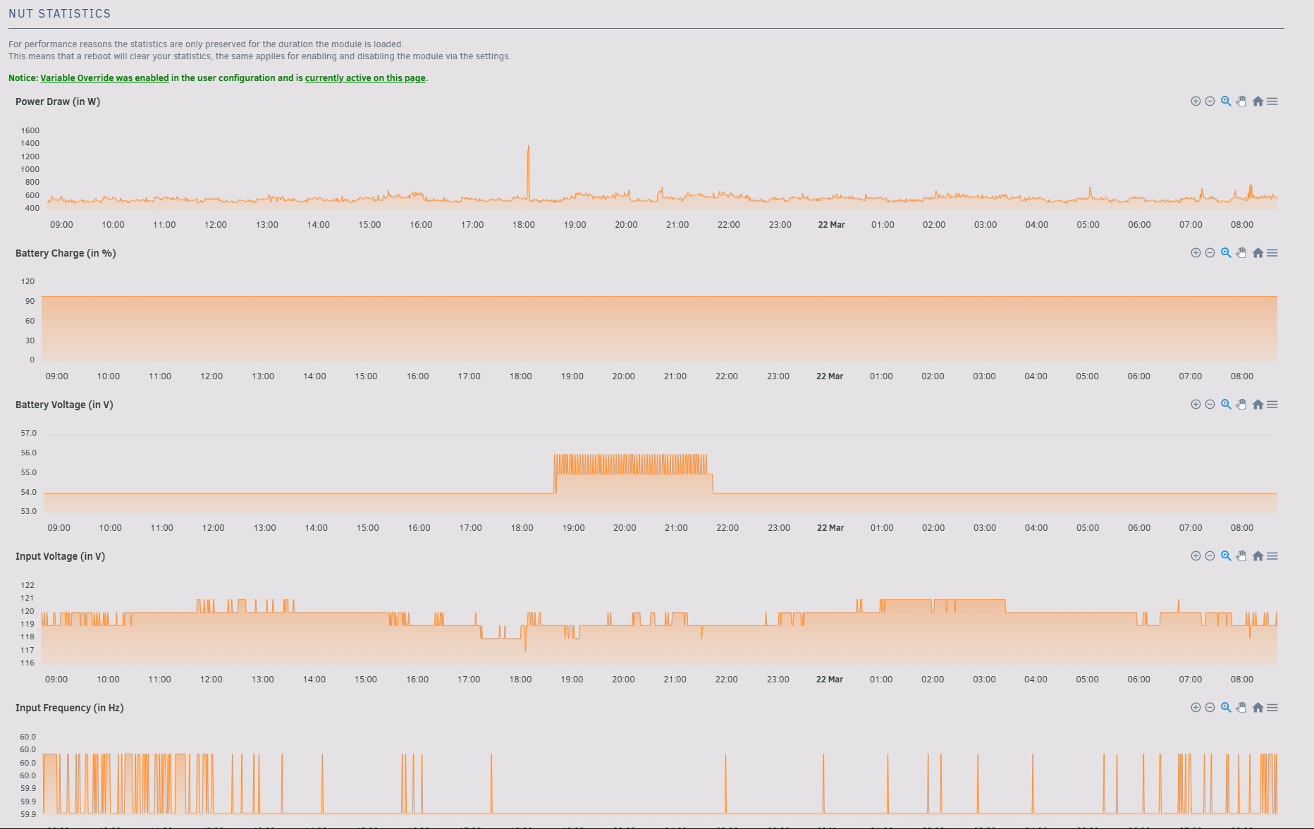

It would be great to see historical stats similar to the NUT statistics page
My server has been turning itself off and I think it's because everything is drawing too much power because there's nothing in logs which indicates issues.
What PSU are you using and what is your system capable of drawing from a psu?
