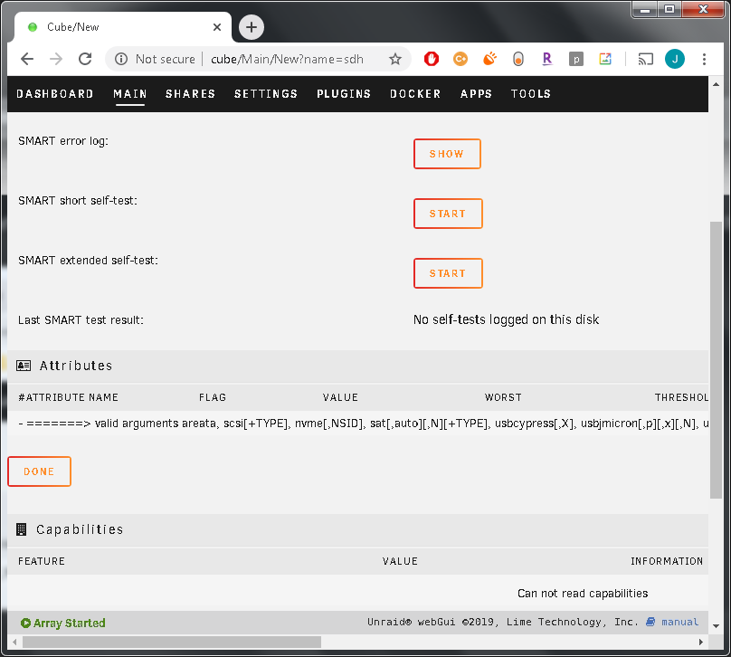

I hate to ask, as i'm sure it's obvious, but I can't find the setting to tweak that'll tell unRAID to stop telling me about high power on hours?
Also I'm not sure if it's related, but SMART attributes aren't showing correctly at this point for this disk.
Note it's an Unassigned device also.  It's on the same controller as all the other disks in the system, and they're all showing up with attributes just fine.

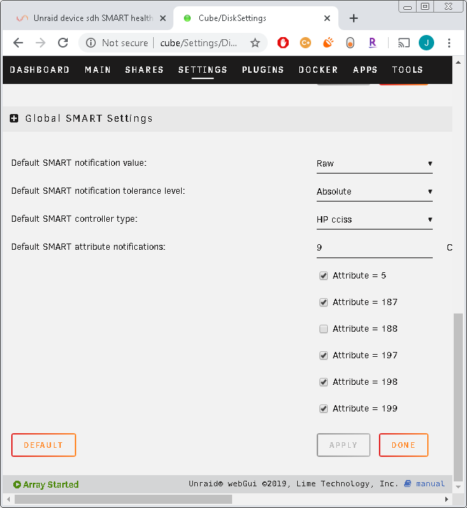

If its sdh, then the problem looks to be more that unRaid can't read the attributes and needs to smart controller type to be hp cciss.  Since it appears to be an unassigned device, I'd try setting that globally in Disk settings, and then set all the normal disks to be ATA
Did that on day one.
unRAID is clearly able to read the attributes, as I've gotten 13 more warnings overnight for the same issue, each time the hour number has incremented by 1.

Remove attribute ‘9’ in the list of default smart notifications. This causes a notification to send when power on hours change value (each hour)
@bonienl Done.  Curious that it all of the sudden started doing it though, as I've had '9' listed there since I put the H240 controller in the machine, and I only started getting warnings last night.

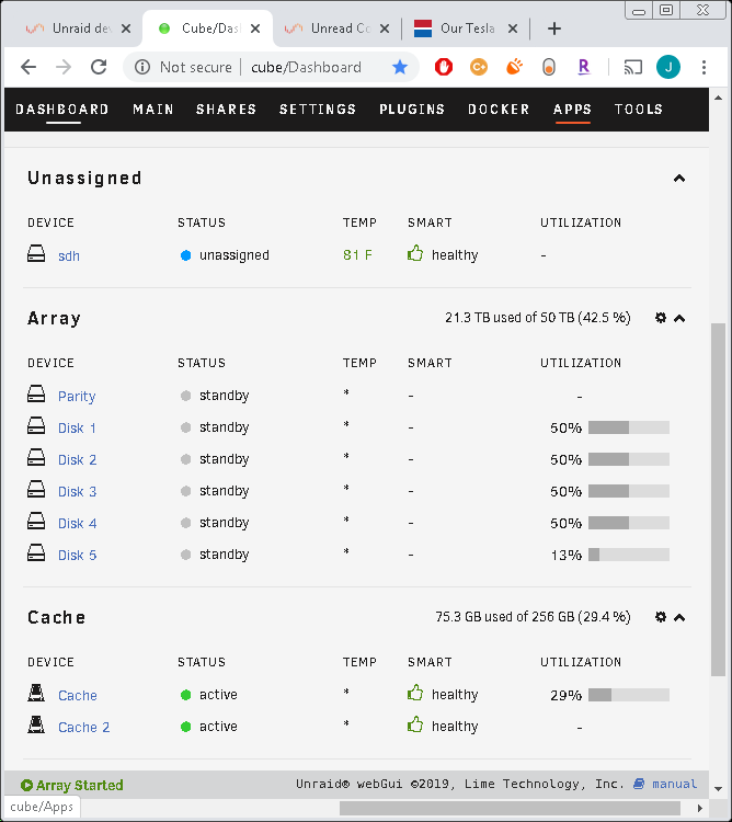

and to add another conundrum to the pile... that drive is now showing a temperature in the dashboard, and ONLY that drive, and ONLY in the dashboard! Main doesn't show any drive temps at all.
did someone slip my unRAID box some kind of roofie or something? :D
