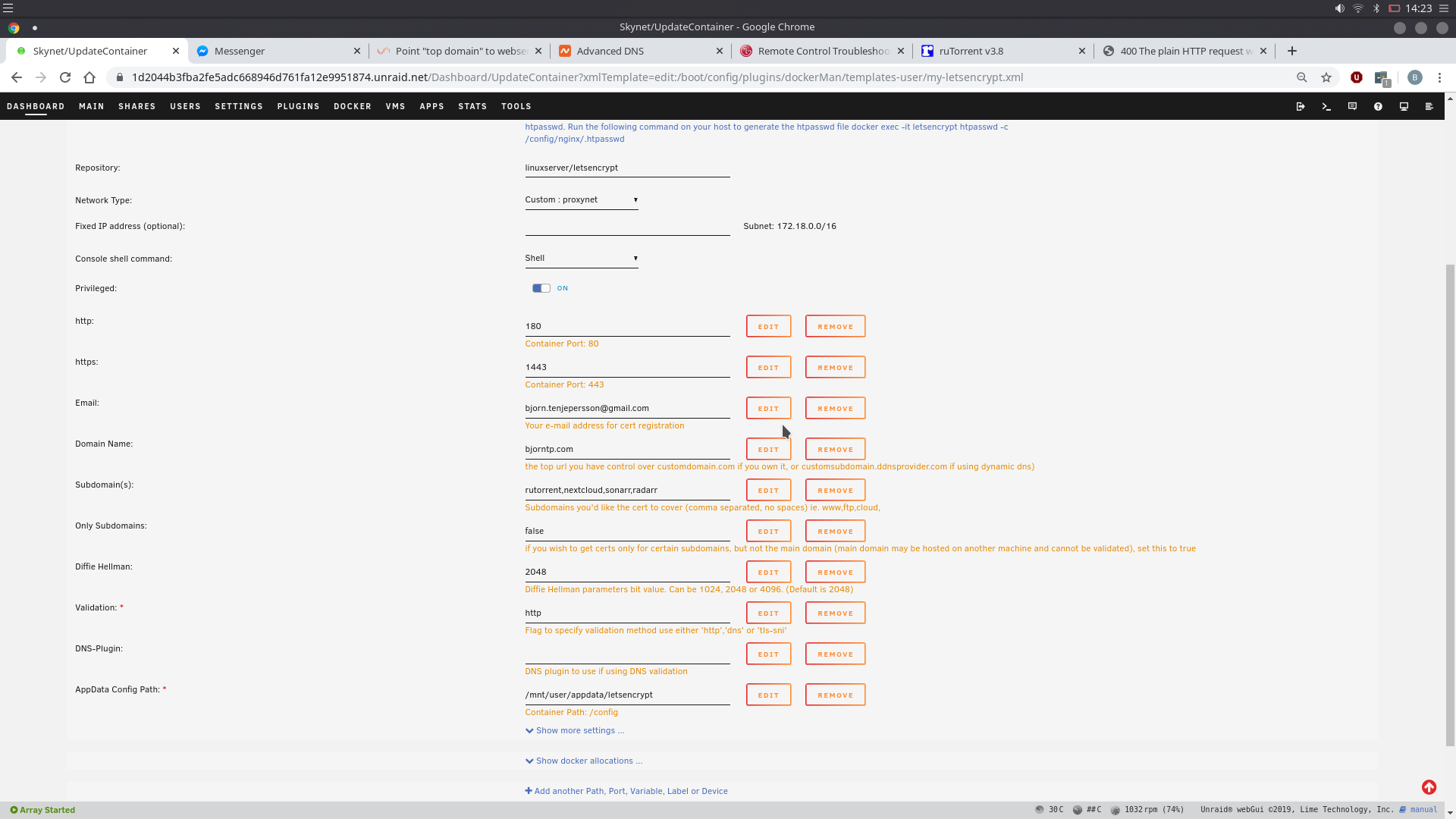

can you send a screenshot of your configuration?
Same error as before
Seems like it works when I add "https://" in front of it. Do you know if there's a way for me to make it work with only the domain?
