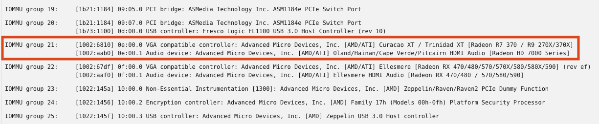

Have you checked the IOMMU grouping in unRaid under Tools->System Devices? Your graphics card should be in its own group, like this;
1998546412_Screenshot2020-01-01at19_59_13.thumb.png.c8f61aa1226c9ecab875227822f13906.png
That's an AMD, but you get the idea. If there's more than just the VGA and Audio Device in a single group, you need to research and fix that. You may need to adjust your system bios and/or configure unRaid ACS override settings inside VM settings.

Hello to all! now I'm posting here, it sems that rtech either made it or threw Unraid away.
I'm  in the same situation as him, I start the VM but the VNC Remote button does not appeared. I followed the video from spaceinvader one of how to pass through the GPU without the second one, and I downloaded from techpowerup the GPU's bios. Still no luck.
My server is booting in legacy mode (Dell calls it BIOS mode), Immos are in the same gruop for Video and audio, I tryed changing from I440 to Q35 (but not creating the virtual machine again since I had a hard time passing a bare metal hard drive)
So, do you know any update on this?
Thanks!
Quick update: I just tried to do it with a Q35 VM and I got the same result, here is part of my .xml:
Don't use a third party bios.
Many of these issues were solved by dumping vbios from the gpu directly: you need to find a way to dump the vbios of YOUR gpu.
Then, if it will not work, we will see ;)
