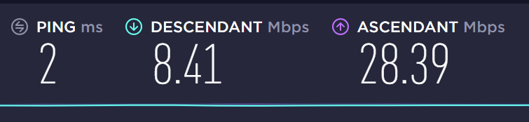

Before Unraid I tried a win10 OS to verify if all devices works correctly and all are OK. However with Unraid I see one problem on WIN 10 VM.
The speed test is limited to 10Mbps to download and the upload is normal.
Do you know if unraid to configure automaticaly a limit to download ?

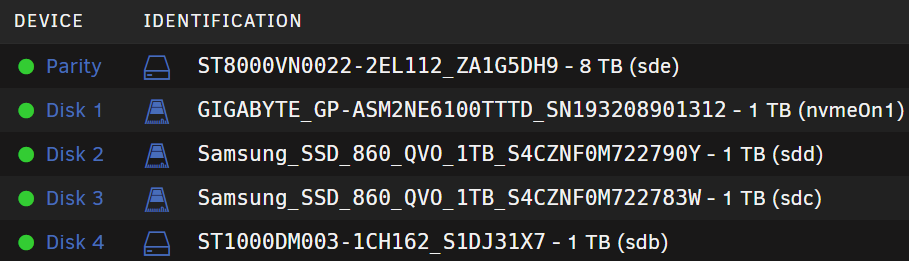

Here is my disks:
To try the connection I used this link: https://www.speedtest.net/

Having SSD’s in the array is not an officially supported configuration.   Array disks cannot be ‘trimmed’ which means that performance of the SSDs is likely to degrade over time.   In addition it is likely to be a waste as write performance is determined by the slower of the drives involved and the parity drive.
SSD’s are normally used instead either as part of the cache or as Unassigned Devices as that gives much better performance.

I recreated a new unraid to remove the parity and verify if my problem is solved. And now I have the same device without the parity and I used the same vdisk.img for my VM.
This one is present on NVME  in the cache part. And the speedtest is always the same...
Do you have any ideas to solved this problem ?
FYI: My connection is working correctly when I tried a speedtest in SSH on the unraid server.
Thank you in advance.
