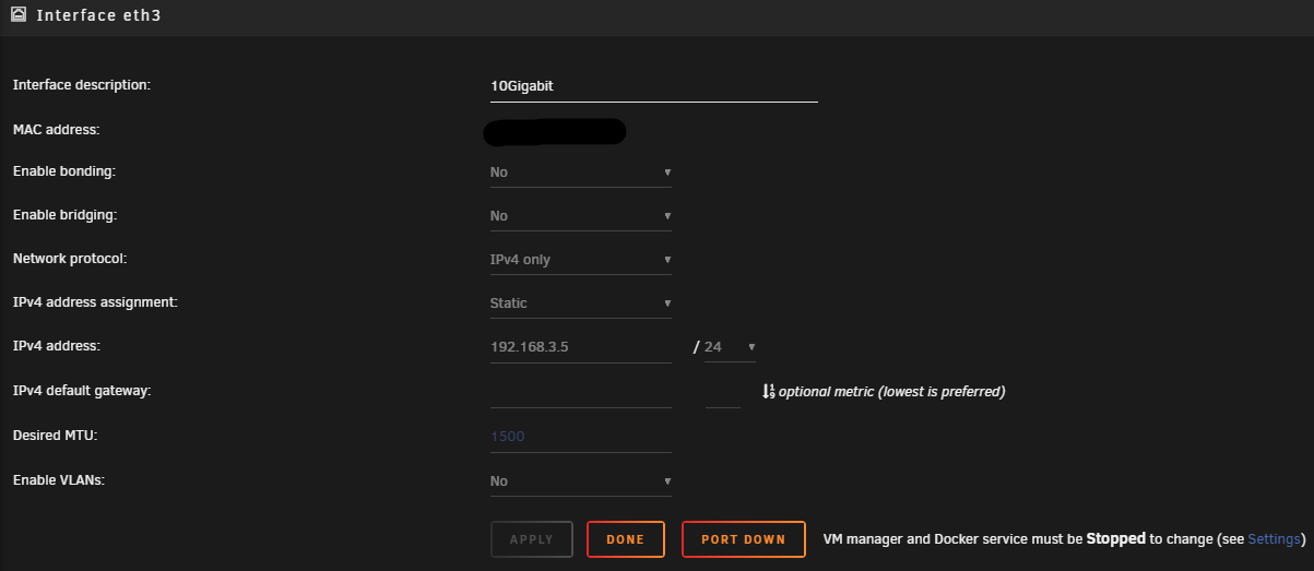

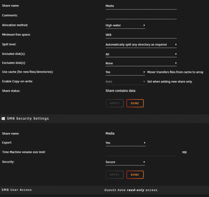

Good afternoon guys and happy New Years,
I have done some research and have tried messing around with the MTU number and i still can get my 10GB link to stay at least at 400MB. I have my main PC connected straight to the server over a 10GB card on both sides. Also, i have an SSD on my computer where i transcode movies and then after is done i send it to the unraid server. The share Media is on "Use Cache" to yes. My two SSD's are on raid 1 under windows. The link eth3 i have it on the 192.168.3.5 and on my Transcode main PC is 192.168.3.6. They are connected directly to each other. Can someone please help me out on this issue. It will start at 500MBs and then die down to 30MBs and flunctuate thw whole time. It will also go to 150MBs and then back down to 40 or 30MBs. I also have a share called SSD Cache and only used the Cache and the same thing happens.

What type of SSDs are those? A lot of the TLC or QLC SSDs have a SLC cache size that enables 400+MB/s transfers but once you fill up the cache with a big file, speed drops to around 40MB/s.
Also realize that I am not talking about the UNRAID cache. I'm talking about the built in cache inside each SSD.
Edited by Gasaraki
I have an ScanDisk SSD Plus 1TB Internal. I believe is SLC.
Those drives are known for terrible write performance
So technically the way I have it setup is good, is just the drive is not good at all for caching.
Most likely, if the initial speed is 500MB/s (while it's caching to RAM) it means the network is writing well enough, though not great, since initial speeds closer to 1GB/s would be better, but main problem appears to be the cache device can't keep up, and very few SATA SSDs can sustain 300/400MB/s, Samsung 850/860EVO and Crucial MX500 can usually do around 300MB/s, for the larger models, 500GB and above.
You can test the link itself with iperf
I don't know who to do this. I will search online how to test this. I do have it installed from last time i tried to figure it out and couldn't. Thank you.
Thank you.
