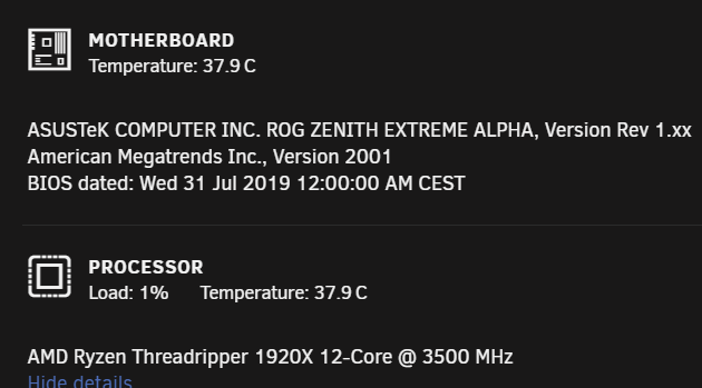

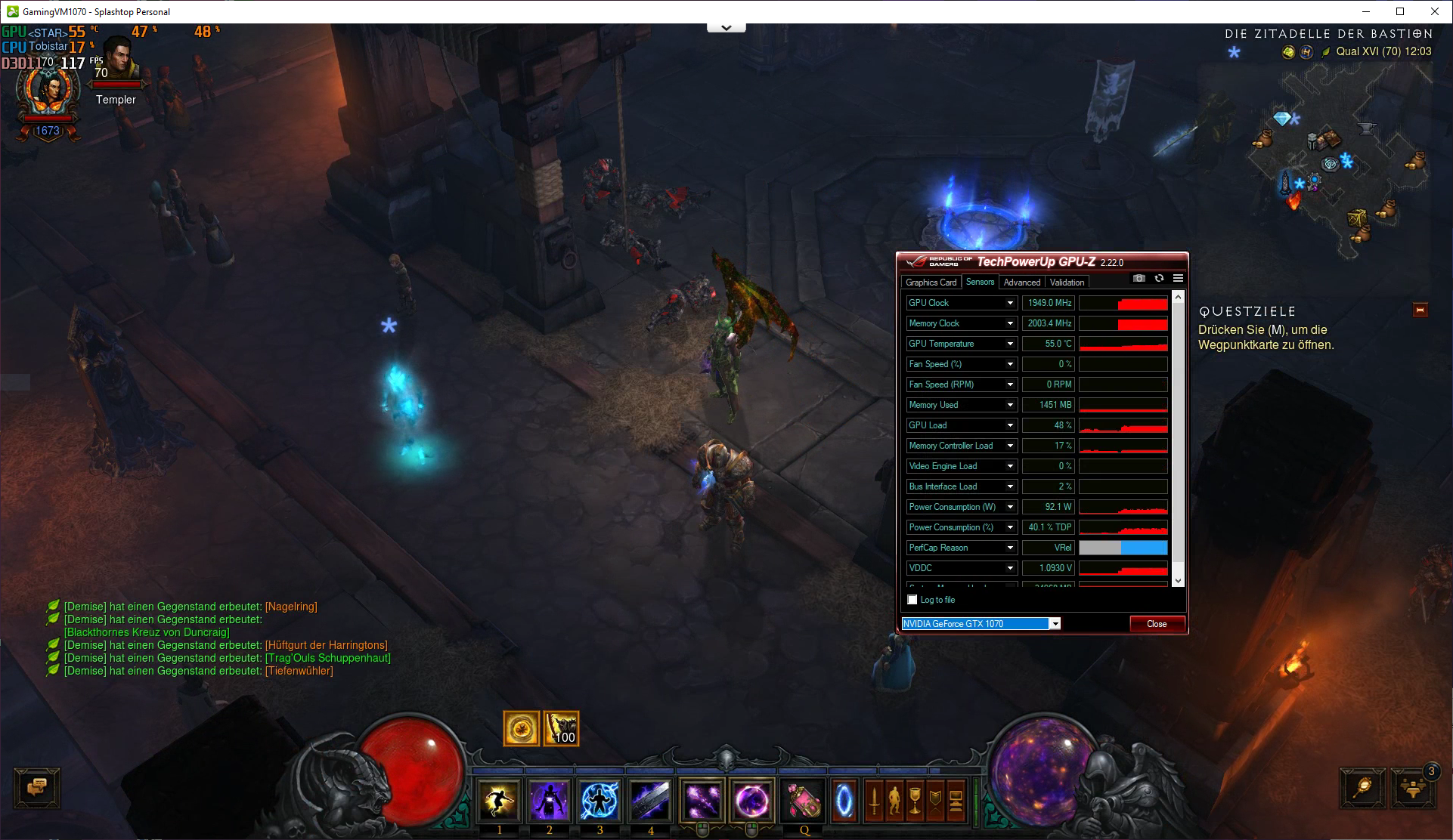

i have some problems with my GPU passthrough. In my Server i have an GTX 1070 and an 1050ti. But in the dropdown menu form the VM template i cant see the 1070 when its is in the primary slot in my mainboard. If i change it to the secoundary slot its show up but then my 1050ti is gone. Another waered thing is that only my 1050ti is in the "system devices" tab. On console and in the "Unraid NVIDIA" settings both GPU´s shown up. On top is the fact that when iam able to passthrough my 1070 to my VM its ran into the VREL limit and the performance is horrible. The Corsair PSU App shows that i draw only 230 watts under load so thats cant be the problem. Did anyone have an idea ?

Edit: i can´t see the primary GPU in this system. I have put my 1070 back into Slot 2 and now i see it but my 1050ti is gone...
