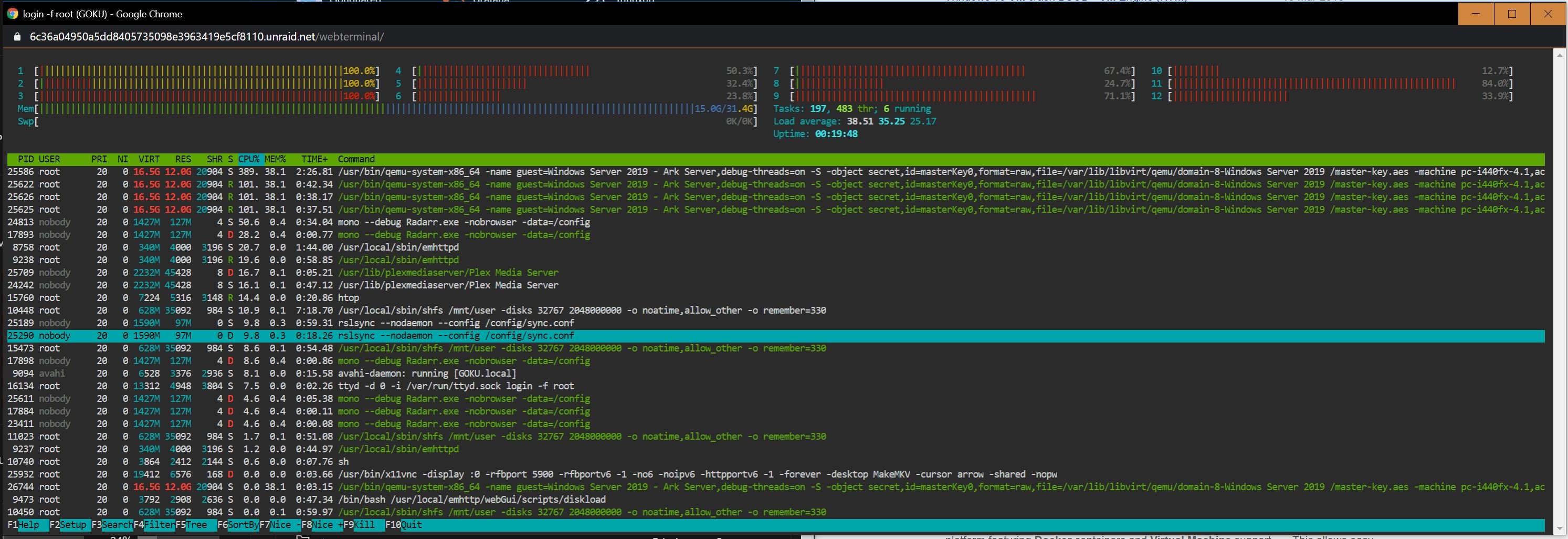

running a server 2019 VM using Ryzen 5 3600, assigned 3 logical cpu cores and 16GB RAM

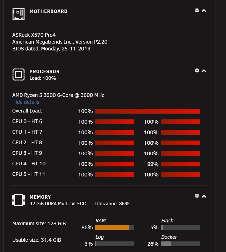

When i start up the VM, the entire unraid server locks up, and all 12 threads are maxed out.  It looks like the main virtual machine image is the issue, but i have no idea why its just started doing this
Any ideas?  Link to pic below

I think i might have figured this out, it looks like when the Ark server performs an auto save, it compressed the file which maxes out the CPU
Although this really shouldn't happen, when the VM is only allocated a few cores - it shouldn't max out the host CPU entirely

I'll try to, but to be honest it locks the server up so bad, you can't even change tabs!  I had to physically push the power button last time
