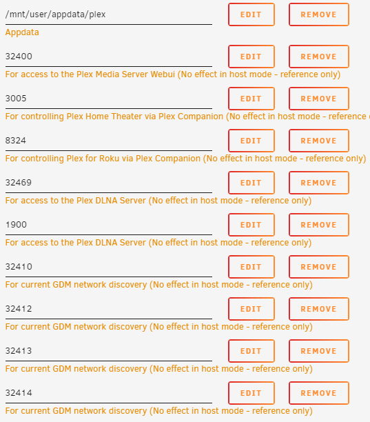

Now, I still don't understand what are all these ports here:
Should I open them as well? Wont the server need that to send the stream to my Plex users?
You only need 32400, all those other ports are not needed when running in host mode. Outgoing connections don't need ports opened or forwarded, only incoming. image.png.feae2b848ef8f23546983dc96abf4195.png
