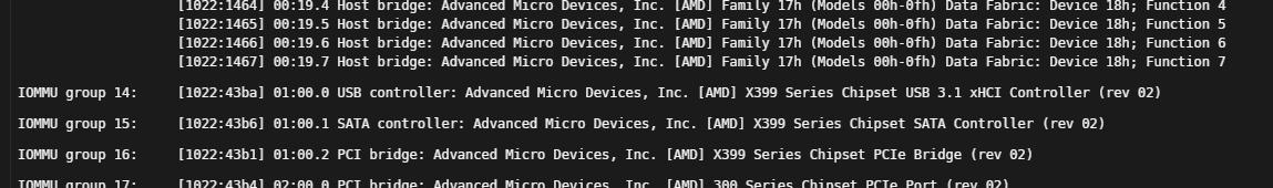

The only reference in System Devices on Unraid that makes mention of USB 3.1 is below.
So if I isolate 1022:43ba with vfio-pci.ids=1022:43ba I should be able to pass-through USB 3.1 to my VM.
Does that sound about right?
That sounds right. As your USB 3.1 controller is isolated in its own IOMMU group, that should work for you.
