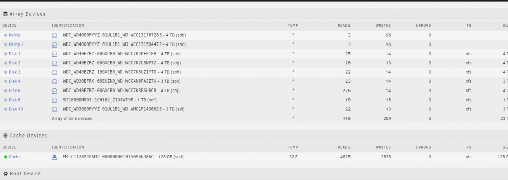

Couldn't watch /mnt/disk5: No such file or directory
fount this in my syslog,  and can't figure out why its there.  I'm not using a disk5.  I looked everywhere and couldn't find any reference to disk5.
 "Jan  2 15:31:23 Server inotifywait[10968]: Couldn't watch /mnt/disk5: No such file or directory'
Any suggestions would be appreciated, or should I not worry about it?

BTW, always post diagnostics.  Much easier for us to look things up.
It's probably coming from dynamix file integrity where it's looking for a disk 5, but since you don't have one, it's failing (Probably wasn't written to support gaps in the installed drives)
Thanks Squid, I put the Diag file above,  Is the dynamix file integrity app worth using in your opinion?  I do leave gaps in my array (for future expansion) Should I avoid doing this if it causes problems?
I personally don't see the point as you can always use include / excludes to confine shares to certain disks.  But, in and by itself gaps won't cause any problems.  But, if you do rearrange, you will have to rebuild parity
