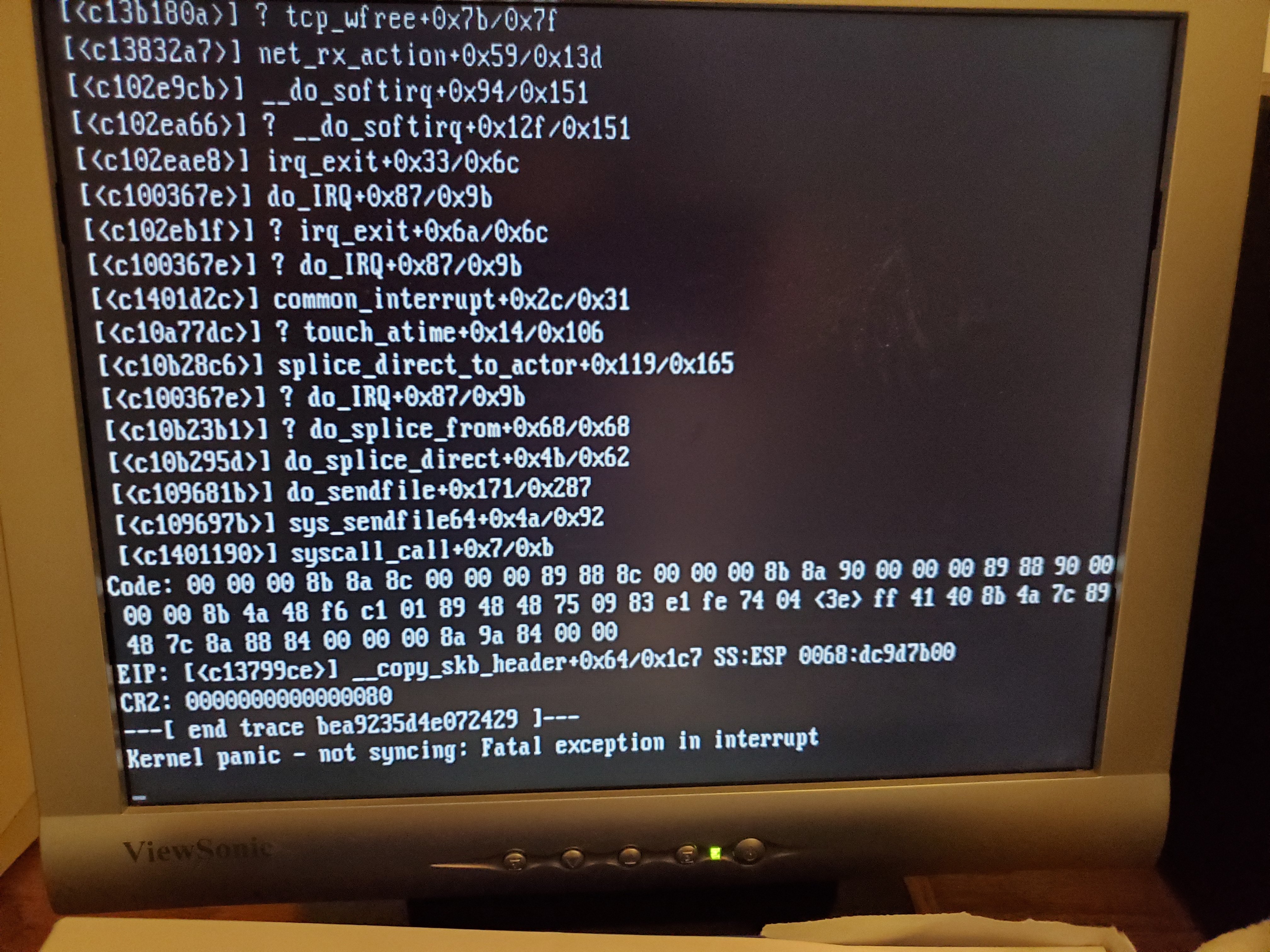

This is actually my second UnRaid server. My first was, for lack of a better word was, "childish". But this second one was built with better bones and had been in service since 2014. Working off memory here, I BELIEVE that I have (3) 2TB drives [1 Parity, 2 data], I also have a "fast" NIC, and a pretty decent SATA controller. I am running version 5.05 of UnRaid and never had any problems. Additionally, the motherboard is a 32-bit so upgrading UnRaid is not possible with this configuration

I had a APC smart UPS (1500 Pro) hooked to this that recently lost it's battery. My house and the surrounding neighborhood are plagued by frequent brown outs and I have a feeling that the plug in used to properly shut down the server when the UPS comes online was not working properly. Upon replacing the battery in the UPS I noticed I wasn't able to access the server via the GUI. At first the only way to get access was through the terminal at the server itself. But recently it's been locking up after about 3 hours of use and it won't allow any input. It's totally locked and the shared drives are inaccessible. So I can't even get to the log file. I managed to get it running, run a parity check, and back up the files that were on there onto several other computers. The files don't appear to be corrupt in any way. And as I mentioned, a Parity check came up clean (for what it's worth). So I am thinking this is a mother board issue mostly exacerbated by the frequent power outages. In case it helps any I have posted a screen shot of the error message I get when the server locks up. Like I said above, if possible I will follow up with a log file if I can get the server to boot up tonight.
So here's what I'm looking to do and where I need some advice. I'd LOVE to get this back up and running again. But I don't know if this is possible. Therefore I need to determine what is wrong (that's where you good folks come in). I would assume that getting a log file is my first step. After that, what is next?

I just wanted to add that I took the access panel off and took the computer out to my shop to blow it out. It was amazingly dusty! I did find that the small CPU fan on the video card was seized up.  But since I run it headless, that should not be a problem. I put it back together and started it up. After allowing it to finish it's load cycle I was able to pull a SYSLOG and upload it to here. Hopefully some of this info can help.

The last thing in your syslog is about unmenu restarting a couple of times. I don't know but that doesn't seem normal.

Have you tried it without unmenu? I think you can just comment it out of your go file.
Have you done memtest?
I started a Memtest before I went to sleep last night and when I woke up this morning I checked and there were a bunch of failed addresses. Not a good sign I take it? I didn't see a way to get a screen dump so I just cycled it off.
The only acceptable number of memory errors is exactly zero. Everything ultimately goes through RAM, your data, the executable code, everything.

In fact you shouldn't even attempt to use a server with memory errors.
Try reseating the modules and repeat memtest.
Thanks for the link to the Wiki. I tried reseating the memory and running a Memtest again. So far I'm about 2 hours in and no errors. But I'm not holding my breath! Even if it came back with no errors I am still planning on upgrading.
If you have multiple Dimms then it's unlikely more than one has failed. Test them independantly, you may be able to get the system running which will make transfering files easier.
