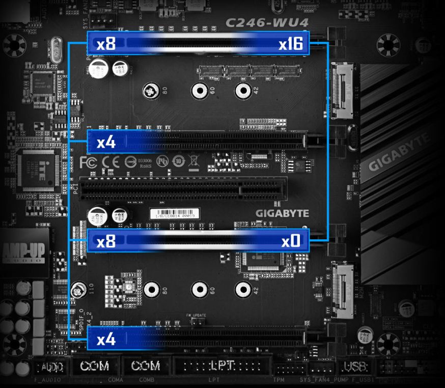

My MB is a Gigabyte C246-WU4 (Its been rock solid, and working with everything I have thrown at it) its has these slots available:
I have the following cards placed like this:
Slot 1 - Quadro P2000
Slot 2 - Intel Pro 1000 VT Quad Port NIC (EXPI9404VTG1P20)
Slot 3 - Empty

All should be fine. Just need to know slot 1,4 come from CPU and 2,5 from C246. And device in 1,4 will usually group in same IOMMU group in native. ( you can ignore this if you don't pass through PCIe device )
In general, it should no big difference which device in which slot, except you found large performance drop in real case.

So performance impact/shared PCI lanes would be:
Slot 1 & 4 - 10 gbps X540-t2 Ethernet Network Adapter / LSI Logic SAS 9201-16i PCI-e 2.0 x8 SAS 6Gbs HBA Card
Slot 2 & 5 - Quadro P2000/Empty so I could potential add another 4X card in this slot? (Or keep my Intel Pro 1000 VT Quad Port NIC?)

I think Slot one has higher priority so maybe I should place the HD controller there?
Slot 1 - LSI Logic SAS 9201-16i PCI-e 2.0 x8 SAS 6Gbs HBA Card
Slot 2 - Quadro P2000
Slot 3 - Empty
Slot 4 - 10 gbps X540-t2 Ethernet Network Adapter
Slot 5 - Empty

Yes, me too, I place two disk controller in those direct connect CPU's PCIe slot.

One question I want confirm from you. Seems your existing setup disk controller and P2000 in slot 1,4 and you pass through P2000. Does they are in same IOMMU group and you need apply something like ACS override to seperate it ?

I would actually like some GPU for passthrough but I would be limited to Slot 5 with 4x
I don't think have performance drop or even negatable.
I use Z390 and never play C246.
Yes PCIe ACS Override setting enabled and a P2000 bios file for the VM works fine did movie editing on it :-)

Yes, Z390 doesn't support ECC memory. The question just to exame does C246 have same behaviour with Z390 in IOMMU part.

In fact, you don't need found x4 NIC, because you have a x16 slot. Stay in Intel NIC.

OMMU - Intel VT-d what behaviour are you talking about?
So you are saying stay with Intel NIC an use one of the fast slots 8x (shared with the LSI controller)

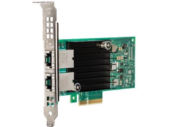

I found this card which looks like its 4x? and have two 2 NICS?
Intel Ethernet Converged Network Adapter X550-T2
When device connect to CPU or Chipset PCIe, their IOMMU grouping will be different.
Yes, the card physically x4, it can plug in x16 x8 x4 slot, this will got max compatible.
X550-T2 native was a x4 chipset ( except X550-BT2 )
https://ark.intel.com/content/www/us/en/ark/products/88209/intel-ethernet-converged-network-adapter-x550-t2.html
So even X550 physically was x8, the card would max at x4 actually.

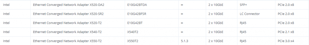

Yes I found this list (Look at the x4 column, this would mean that the new 550 only requires 4x and the old one requires 8x)
Or the physical slot is 8x for the old card and it oly uses 4x?)
Anyway I am going to get a X550T2 if someone can confirm its plug and play with Unraid? Anyone....? :-)
I miss that, most X550-T2 were x4 ( physical and electrical ), old gen usually x8 and PCIe 2.x only ( physical and electrical )
