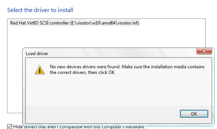

Windows 10 - Fails to install, no device drivers found for storage
I can see a couple of posts regarding this but i cant figure it out, any ideas?

Any help please?
Not sure what is going wrong, but have you watched the SpaceInvaderOne videos on installing Windows into a VM on Unraid?   One of them might give you a clue as to what you did that is different to the process he uses in his videos.
yeah i think i have watched all of his videos. They have been great. But i am failing at the same step every time. For me this is a deal breaker of using unraid vs going back to Hyper V or ESXi. I really need to have a windows machine. :(

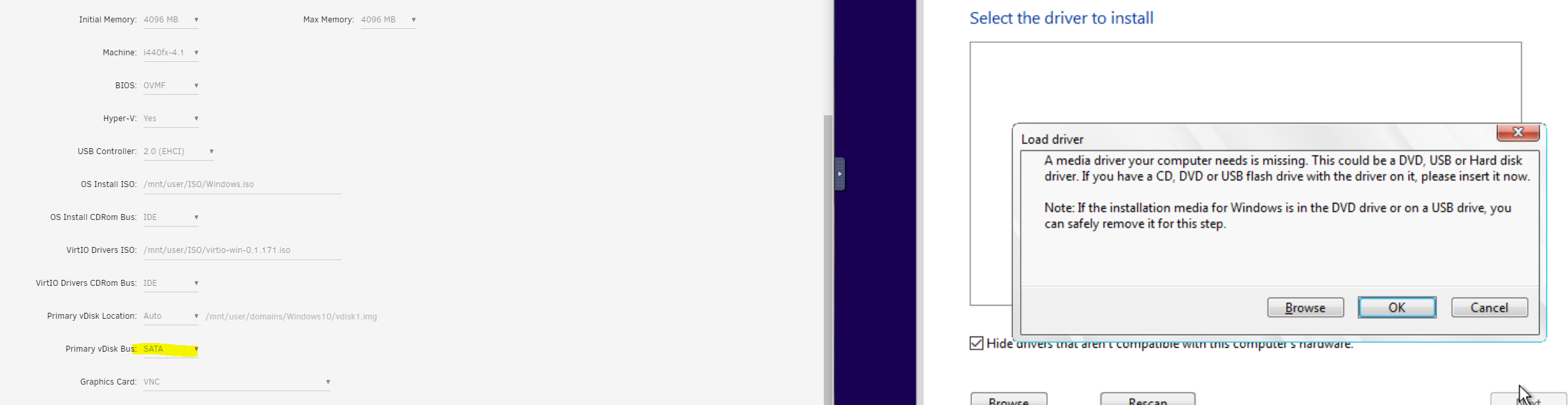

I have no idea why you are not able to see the virtio drivers, but you could try changing the vdisk type to SATA from virtio in the VM definition which should allow you to get the VM running without the need to install the virtio drivers during install.
Ok tried that but still the same result. When I create the VM i can see the Vdisk img being created. but its asif the VM cant see or doesnt have access to the newly created img file. so sad! havent got much longer left on the trial and i defo need 1 Windows machine to run my CCTV software :(

just had a thought - what size vdisk did you create?     If the size is too small I think you can get strange error messages.
I have tried 50G 30G and 60G. I have just tried setting it up as a Windows 7 machine and i can see that it uses the older SEA Bios. I have a quite old server (circa 2011 i think) However this didnt work, same error.

Just took a look at this thread and did a compare to the xml I have for my Windows 10 VM's. One difference I see is that I am using a different (older) version of the virtio iso. (virtio-win-0.1.141-1.iso) vs (virtio-win-0.1.171-1.iso). I have 2 Windows 10 VM's running, and the latest one was created a couple of weeks ago with 0.1.141-1.iso without issue. Maybe try a different version than virtio-win-0.1.171-1.iso.
I only mention this because the error says to insure that the drivers are on the media.
