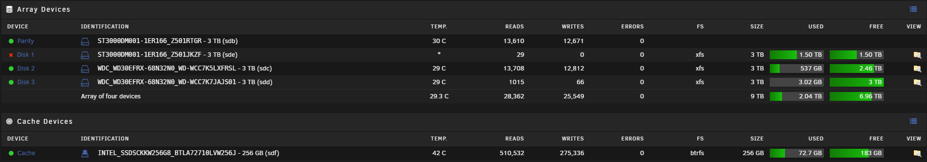

So I logged into my Unraid UI (v6.8.0) the other day and had some notifications that a parity check (run weekly) had failed, and some errors were found in disk 1. This disk is now disabled.
Server hasn't been moved or touched for a few months, just came out of nowhere. I did have some temperature warnings as it's been stupid hot here lately.
Diagnostics and SMART report for disk 1 is attached, if anyone could some assistance please?
Cheers.
skynet-smart-20200104-2249.zip skynet-diagnostics-20200104-2344.zip
Looks to me like the disk is toast.
187 Reported_Uncorrect       -O--CK   001   001   000    -    65535
197 Current_Pending_Sector  -O--C-   001   001   000    -    17480
198 Offline_Uncorrectable       ----C-   001   001   000    -    17480
Compared to one of my seagates - ST4000LM024
187 Reported uncorrect                  100      100   000      -  0
197 Current pending sector            100      100   000      -  0
198 Offline uncorrectable                100      100   000      -  0

Yes, that disk must be replaced. But keep it handy in case there are problems with the rebuild since it's not entirely clear what the state of parity is.

A further question on that, I have another Seagate drive (same model) as the parity, and the other 2 drives are WD Red (which I understand are designed for NAS use). So I would assume the best option would be to have the WD Red drives used for Parity and disk 1, with the other Seagate as a spillover.
How can I rearrange the drives to this format (ie. Parity = WD1, Disk 1 = WD2, Disk 2=Remaining Seagate)

I haven't, as I haven't ever had the need so far. However it seems like shrinking the array would be the best option for me using this guide?
I don't need to replace the failed drive currently, I have enough space.
Using the above guide, can I re-allocate disk 3 (empty) to replace disk 1? I'm assuming i'd have to follow a specific process to do so...
You can copy the data from the emulated disk1 to other disks then remove disk1. I recommend the "Remove and Rebuild Parity Method" from that link. It is simpler and just as fast. At step 4 New Config you can assign the disks however you want. Just make sure you don't assign a data disk to the parity slot.
