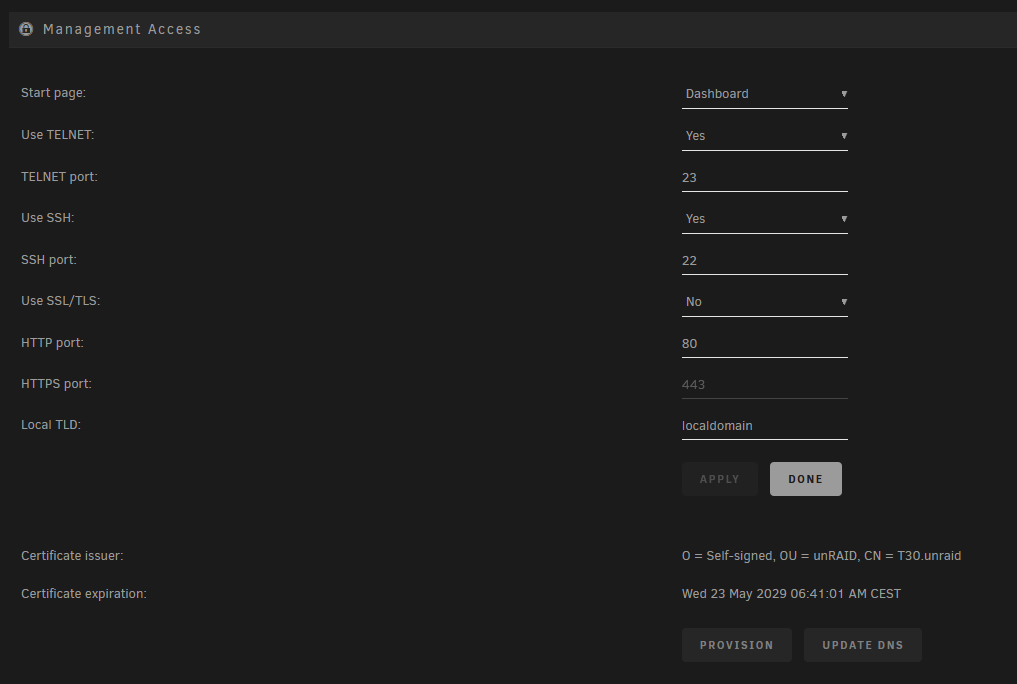

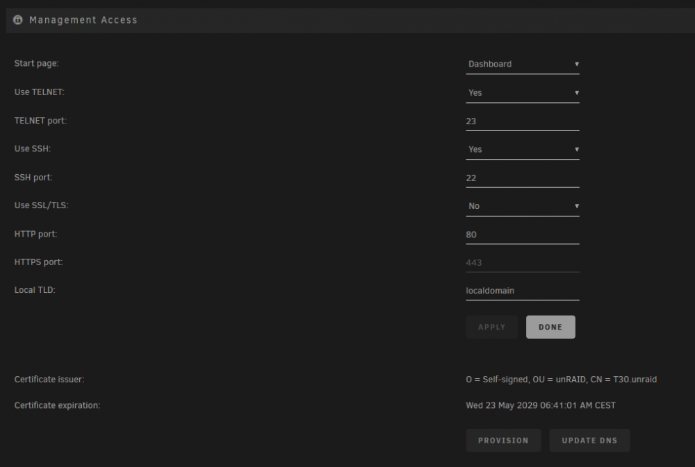

Hi @ljm42 - thanks for the plugin.
I wanted to test this but of course, as may a lot of users, my upnp client is disabled.
The hint with the management page is good, but I dont have any upnp options in there?!
Im using 6.8.0.
Im using 6.8.0.
The line shows up there if Dynamix Wireguard is installed
A bit difficult or? But yes, worked. Thx.
Ah, so upnpc is disabled by default and you need to install the Wireguard plugin to enable it. Interesting. I will update the OP. Thanks!
Edit: Starting with Unraid 6.8.1, the Wireguard plugin is no longer required.
Edited by ljm42
