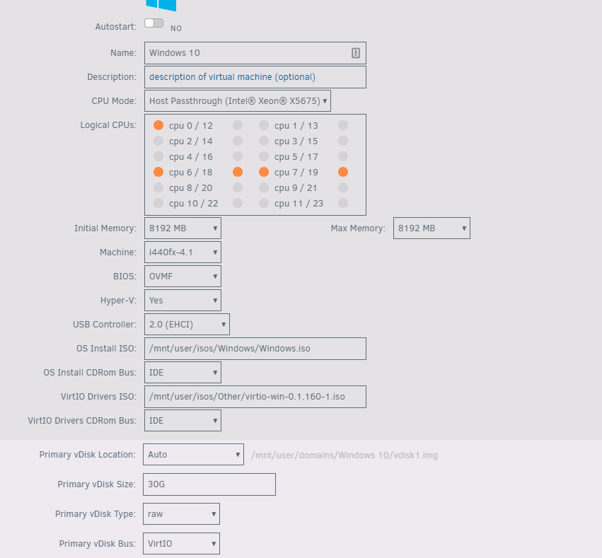

Hello all,
I have been messing with unraid for a while and just migrated to a Dell R710 rack server.
Now I would like to try installing a Win10 VM.
Set up is done and we get to the install stage but can't find a driver in the "virtio-win-0.1.160-1.iso" file that works.
Tried everything and no disk shows up....
I have tried all of the possible options and the only one that shows a driver that is compatible and it doesn't work.
I have also search the $#^& out of this forum with no joy.

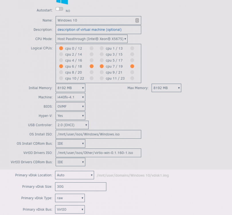

This is the sheet but can't find a driver that works.
If anyone has one of these servers and/or has a suggestion please let me know.
Is it the vdisk type? vDisk bus? CPU mode?
Just too many options and combinations to do trial and error.
Thanks in Advance
Toolman

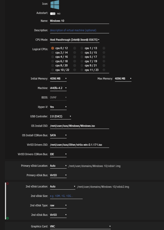

Well I am not sure what did it but I have a Windows 10 VM up and running. I changed a few things in my property sheet and that seems to have done it.
First is my hardware setup:
Dell R710 server, 12 Xeon 5600 Series processors (24 with HT), 48G memory, 6 Sata HD
This is what I did to the best of my recollection:
1. Grabbed a new copy of windows 10 from Microsoft using the Media Creation Tool - https://www.microsoft.com/en-ca/software-download/windows10
2. Updated driver files to virtio-win-0.1.171.iso at https://docs.fedoraproject.org/en-US/quick-docs/creating-windows-virtual-machines-using-virtio-drivers/
3. Changed the OS Install CDROM bus to Sata
4. VM Property sheet:
It then booted into Windows install.
5. To get the disk to work I had to use the Fedora Red Hat AMD dirvers (?!?!? not sure why this worked since this is a Xeon system).

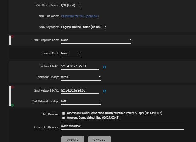

6. Install completed .... but I had no internet so .....
7. Installed the network driver ....
8. Up and running
I also installed a graphics driver to get a more reasonable screen size:
and a virtual sound device....
Thats it and it works wonderfully.
