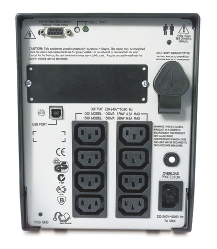

December 1, 201015 yr Author I'd recommend the APC Back-UPS 650VA http://www.scan.co.uk/products/650va-apc-tower-ups-with-internet-dsl-fax-modem-protection-retail-box Edit: I missed that you are running 20 HDD. I would measure the watts...or estimate using this- http://lime-technology.com/forum/index.php?topic=6695.msg64801#msg64801 I used the calculator and it says I need roughly 440 watts! But I think it works on the assumption that all 20 HDD are spinning. Does this one use a propriety usb to rj45 cable? http://cgi.ebay.co.uk/APC-1000-UPS-New-style-USB-Guaranteed-New-Batt-/390206923065?pt=UK_Computing_Networking_SM&hash=item5ada252139 Joe L. Your second paragraph seems to be the wrong way round. There is no LAN connector on the back of the this UPS.

December 1, 201015 yr Author Hi Mbryanr, If you look at page 3 of the manual it gives warnings about using a different serial cable than the one that is supplied but there are no warnings about the USB cable. This leads me to believe the USB side is not propriety.
December 1, 201015 yr Hi Mbryanr, If you look at page 3 of the manual it gives warnings about using a different serial cable than the one that is supplied but there are no warnings about the USB cable. This leads me to believe the USB side is not propriety. On the UPS's I have both connect with a Ethernet-Like connection from the UPS side to a standard USB connection on the other. I know this cable is proprietary, not sure about the others though.
December 1, 201015 yr Hi Mbryanr, If you look at page 3 of the manual it gives warnings about using a different serial cable than the one that is supplied but there are no warnings about the USB cable. This leads me to believe the USB side is not propriety. On the UPS's I have both connect with a Ethernet-Like connection from the UPS side to a standard USB connection on the other. I know this cable is proprietary, not sure about the others though. This model has a Type B USB port to Type A USB cable. Who knows what they did with the internal connections...I wouldn't experiment. It may not be proprietary, but they have this warning though: Use only interface kits supplied or approved by APC. and since the cable is included...easy decision.
December 1, 201015 yr Author I wouldn't mess with the serial connector but I would test the USB connector by using a non-APC USB and then plugging this into my laptop/PC.
