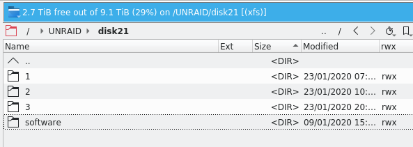

This is strange I used MC and copied each disk to a folder on the new drive!
I stopped all dockers and VM's and today (its been running for some time) I see this new folder? "software"
Another of my shares.... is unraid coping files around while I do these transfers?
UPDATE: A laptop on my network had a open excel file that it saved back to Unraid as a temp file... So I deleted the directory :-)
Edited by casperse

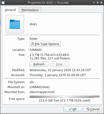

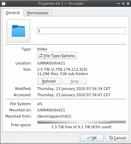

Should I have changed my share settings so they all exclude the drives I want to remove?
What happens to the data already on the drive after they are excluded?
Checking the file sizes after copying with Krusader, they show some differences?
image.png.2ec9f739d81c451879576ffb92ba8399.pngimage.png.24ae0ef990f566527faf76a6a0595edd.png
Running a compare check now....with Krusader
or maybee I could do a: rsync -narcv /mnt/disk1/ /mnt/disk21/1 ?
(I have disabled all docker an VM's so I should be relative safe)
Edited by casperse
If you like, you may sync again and remove the different, that's why I always suggest moving data to new directory in first.
Edited by Benson

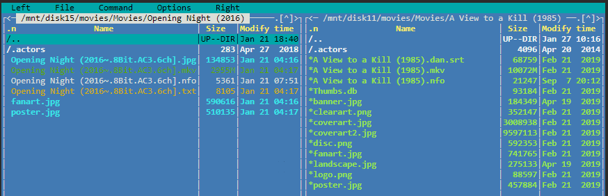

I just noticed some strange thing... after transfer from USB - HD (UAD mount) to Unraid (Using mc in a prompt) I have this view with wildcard *
UPDATE: I think all files are marked as executable - running a "New permission" to see if that fixes this... 🙂
