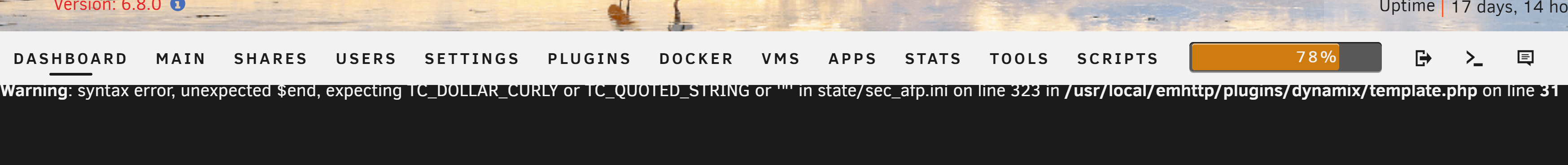

Most of the  GUI is corrupted with this, this is new as of just a few hours ago and I have no idea what it means. Any help would be appreciated.
Top of my head, your flash drive is corrupted.  Can you post your diagnostics

Or bad memory (run a memtest), as the file being referenced in the OP's screen shot is in RAM
Yes, that could certainly be a reason for various and multiple recurring issues. And memtest should definitely be done if only to eliminate it. Though I wouldn't expect it to actually kill a flash drive.

Plugins folder doesn't exist on USB yet still getting dynamix plugin error.

Ok, so no luck still. I have only one of the sticks in there and still the same issue over and over again. Where the heck is the dynamix stuff being loaded from? as in the screenshot in the first post, if that location is in RAM, where is it copying it from if there is NO plugins folder on the USB at all?
