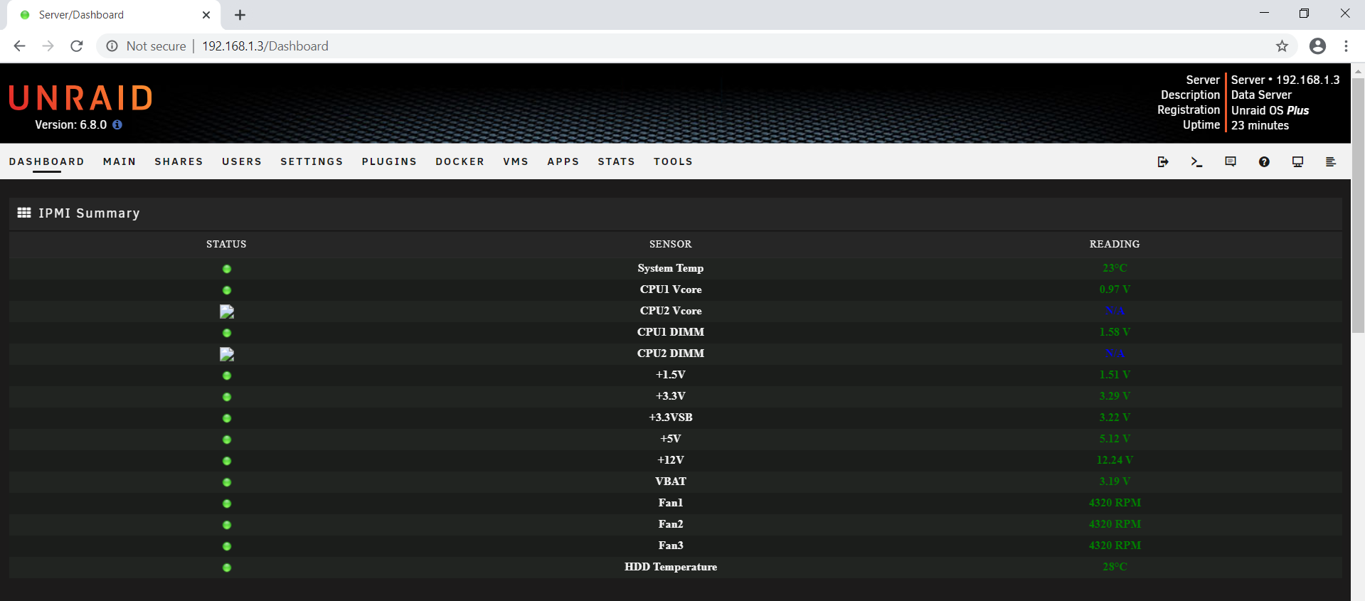

Sent from my SM-G973F using Tapatalk
I just noticed only half my memory showing with one cpu. But with one cpu it doesn't matter what socket use will have to pull some sticks out.
