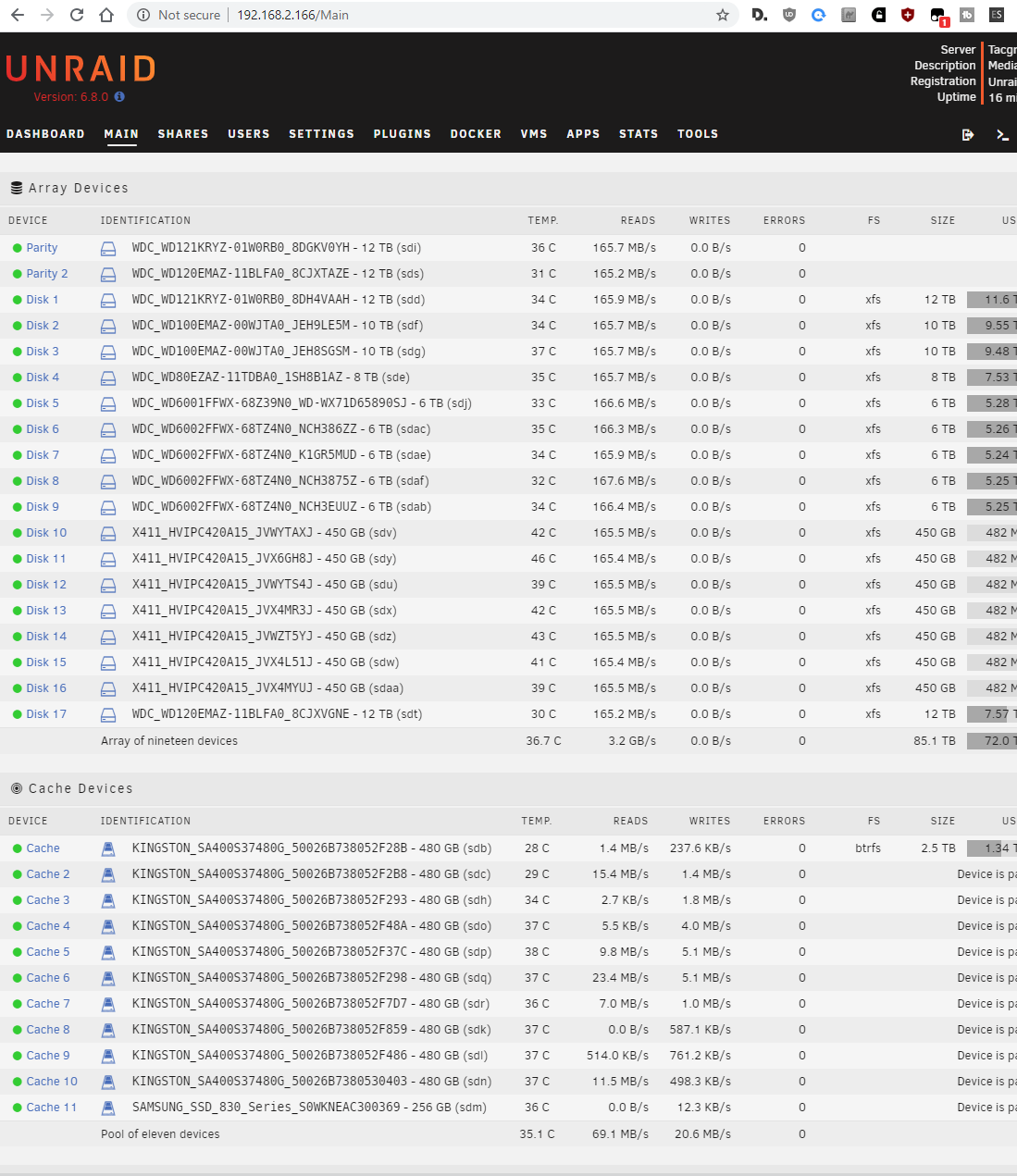

I'm going to put this image here in case I have future problems and can't remember drive assignments, it's running a parity check due to the unclean shutdown but that's fine.

I actually keep a hard copy and print a new one when I change disks.
