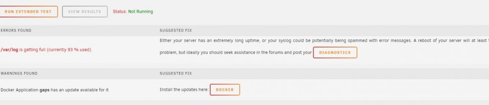

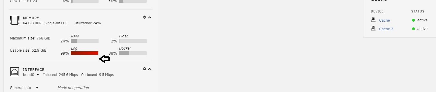

Need help with /var/log File full and keep spamming
I am look for some help with this problem. I keep getting this warning that log file is full and i cant find or figure out what is going on. I request some assistance if anyone has any time.

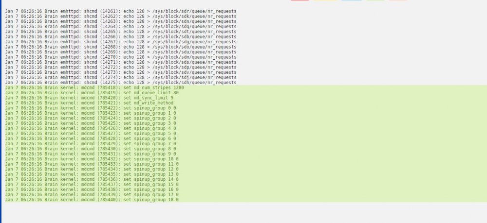

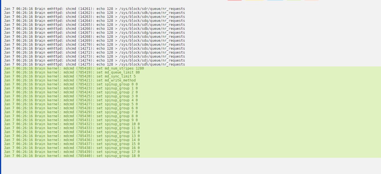

Your syslog is full of errors on multiple drives. Do you not see any Errors on the Main page?

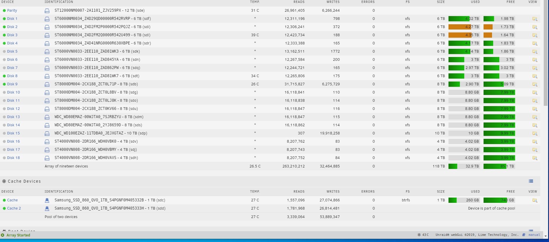

Go to Main - Array Devices and post a screenshot. Be sure the screenshot includes the Errors column.
Go to Dashboard and post a screenshot of the Array section.

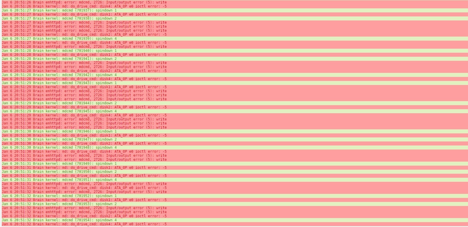

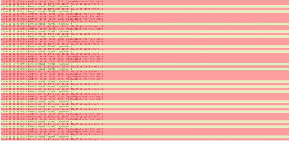

Unraid can't spin down SAS devices, that's what's causing the errors, disable spin down for all SAS disks.
I changed the spindown for all my disc under each disk individually to 9 hours each because i didn't see any disable button so i just choose the longest time, dont know if I'm doing this right? The errors went away. i am going to run new SMART test on all my drives will update after.
There's a "never" option.
ok i will choose that one thanks. I will let you know if it comes back.
