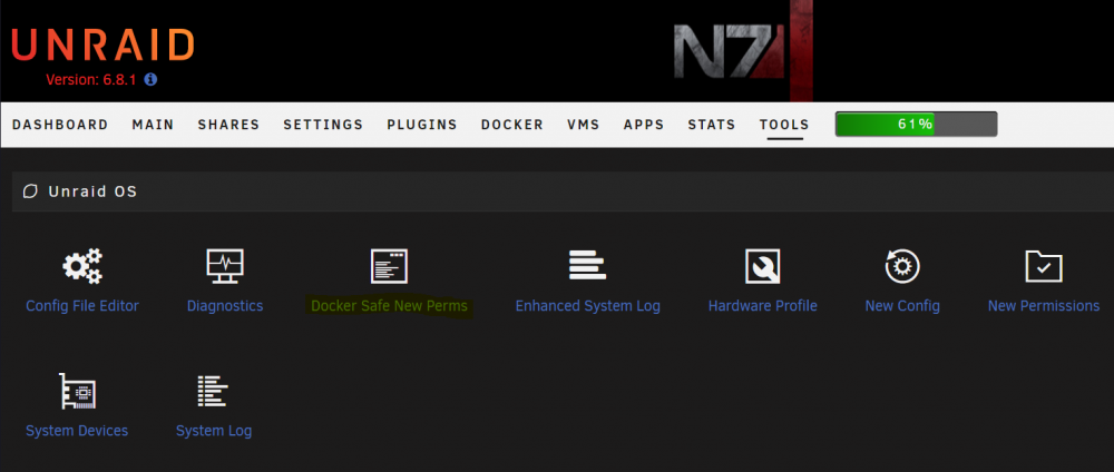

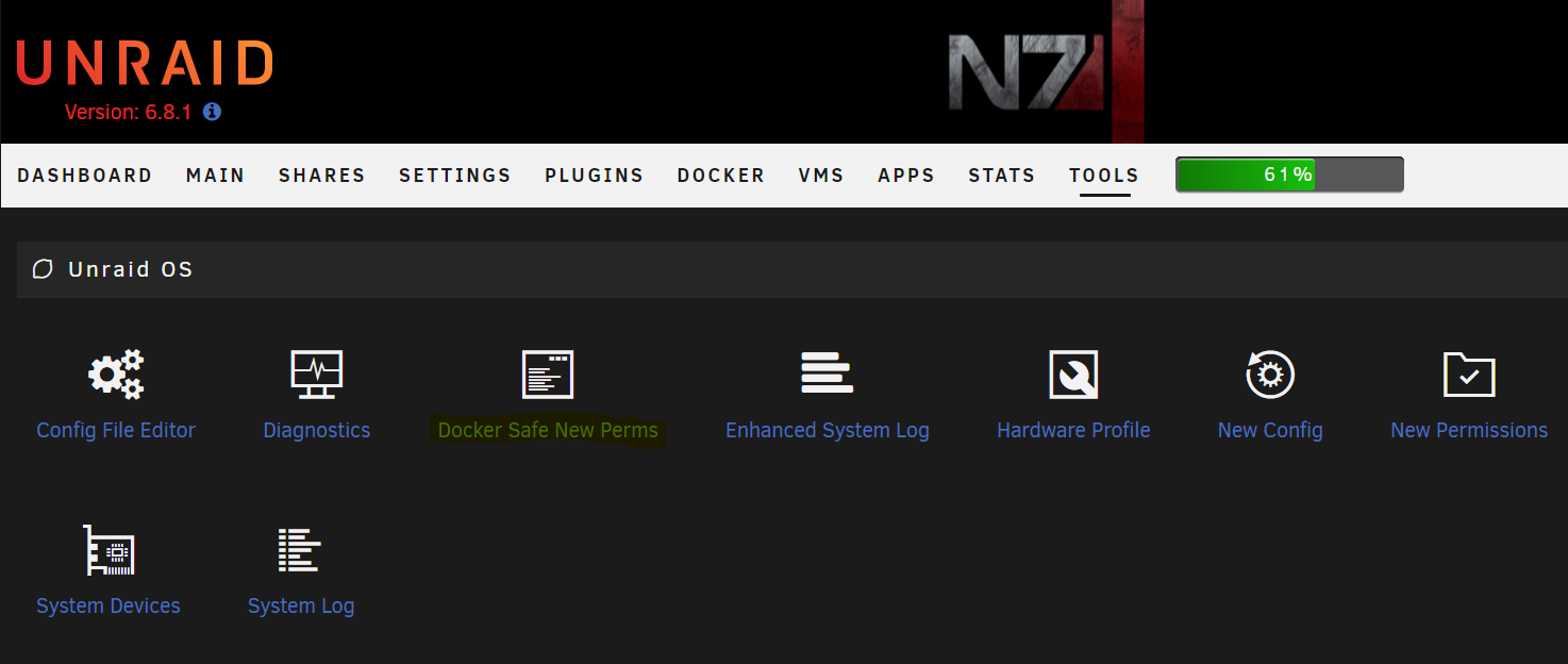

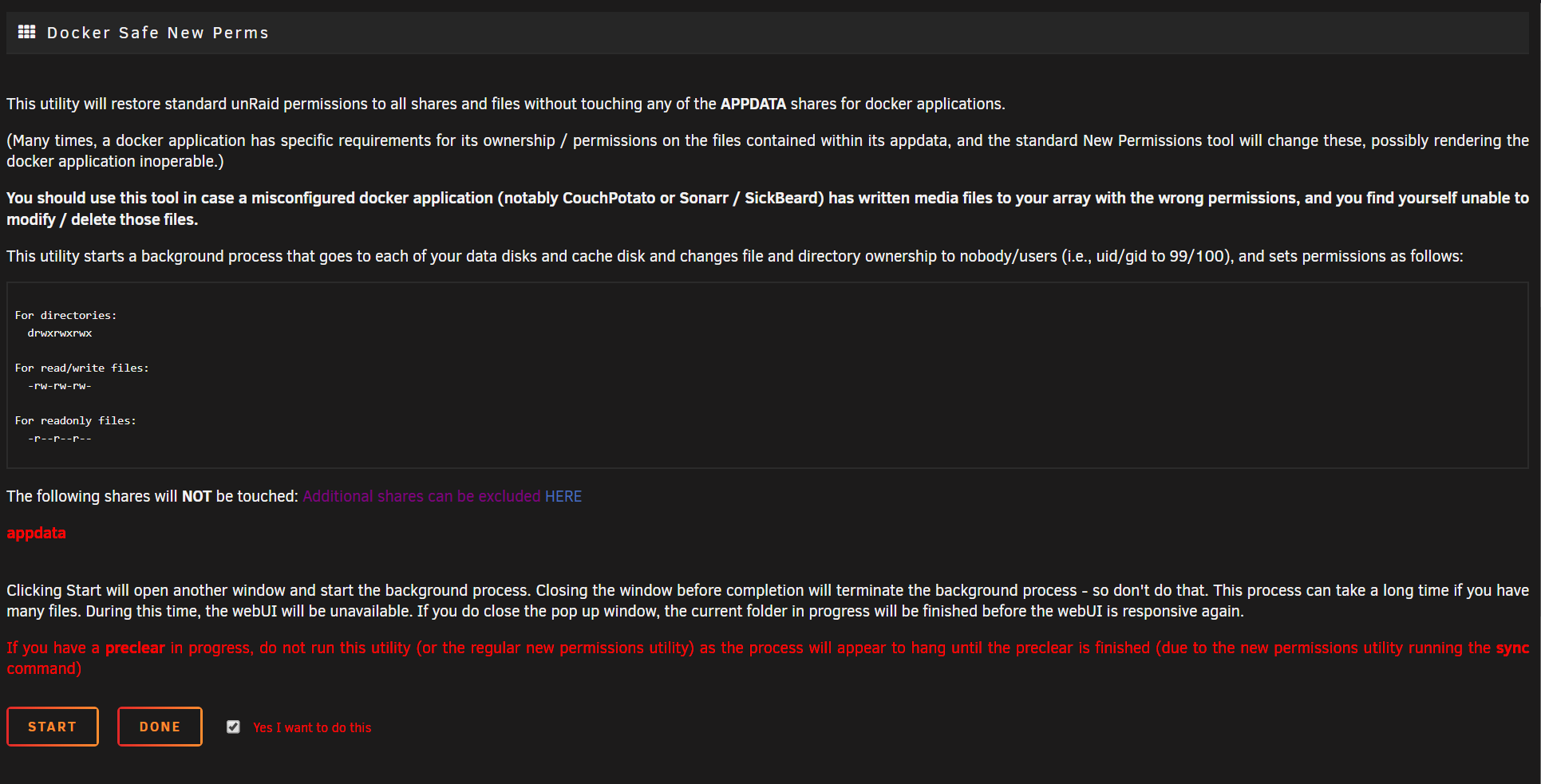

For data disks, I usually run the "Docker Safe New Perms" script to reset permissions across the array. It is safe...and resolves similar issues, especially when uploading files to the array from OSX.
You also might be running into issues if certain dockers are running and have file locks. I usually run my cache share script when all dockers are disabled and the array is stopped for that reason.
Edited by falconexe
Oh well, I knew about this option, but I'll concede to mess up some perms I set myself for the sake of that script, and I'll let you know ;)
Edit: Dockers stopped, perms resetted, Dolphin's share still denying access. I feel like this one will tickle my pickle quickly and yeet off of my server.

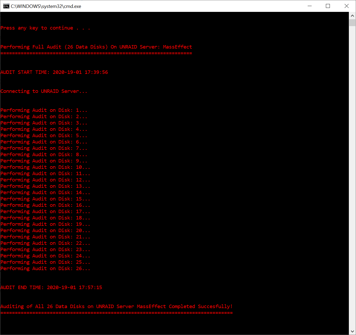

Dude, this is impressive. It is way more crazy and complex than I could have imagined. You definitely taught me some new techniques. And I noticed your PowerShell injection.
I just finished running the audits using your script and got the EXACT same results down to number of lines in each file and the exact same size of output files down to the byte. So both of our scripts match up output-wise exactly. Peer Review Complete ha ha.
Nice work!

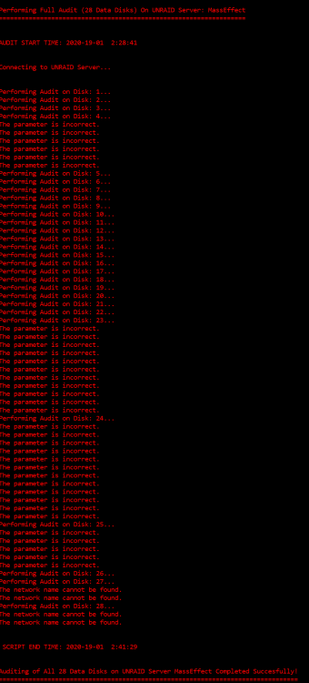

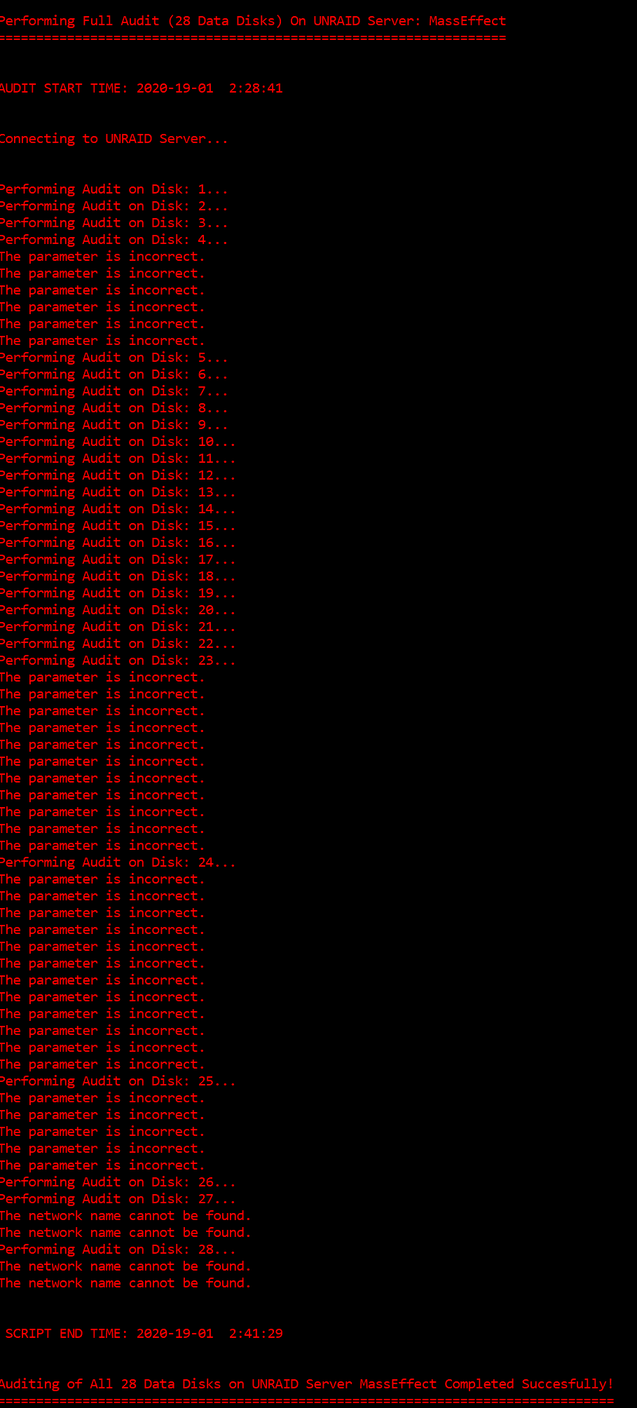

No worries. I have been having some weird stuff with my scripts too. The Meta audit sometimes runs into 1969 files that are missing the creation date on the folder. When this is encountered it outputs "The parameter is incorrect." into my screen output. I spent many hours last night touching files to reapply these attributes.
I was able to find these erroneous files and folders by going to each disk share and running the following command on the UNRAID terminal: find . -type f -ls |grep ' 1969 '
Then you "touch" the files and it should fix the issue.
Here is what it looks like when it happens in the script. You can see this exact output by just running the command in CMD natively, so it is not script related. Super freakin annoying...
I had this completely fixed last night after fixing all of the files in question. I then re-ran the audit and I had clean screen output.
Then this morning I ran it again and I have more of these lines in different disks. So not sure if it is always the "1969" issue. This does not happen on the RAW "DIR /s /b" command, only the META "DIR /s" command.
Anywho, I'll keep trying to track the issue down. I hate intermittent issues! If anyone else is seeing this on their server, I would be very curious. Again the scripts work perfectly. It is the actual data throwing the exception.
Worse case scenario, I would love to just suppress the error line on my output screen. Any thoughts on how to do this?

26 minutes ago, falconexe said:
Thanks trying this now...
Yep that worked. Thanks.
Echo Performing Audit on Disk: 1...
DIR /s /b "\\%ServerName%\disk1" 2>NUL 1>"%OutputPath%\%CurrentDate%\%FileNameRaw%"
DIR /s    "\\%ServerName%\disk1" 2>NUL 1>"%OutputPath%\%CurrentDate%\%FileNameMeta%"
FOR /L %%i IN (2,1,%DataDisks%) DO (
Echo Performing Audit on Disk: %%i...
DIR /s /b "\\%ServerName%\disk%%i" 2>NUL 1>>"%OutputPath%\%CurrentDate%\%FileNameRaw%"

13 minutes ago, Keexrean said:
Ran both commands.
Can confirm it's not what was actually messing things up on my side.
The directory search returned nothing.
The file search returned just old files from damages drives and/or NTFS partitions that dropped to raw, and none of these files were the ones making the dir command crash, I can even find them in the disk audit log I ran yesterday.
No worries. At least you know that is not the issue.
