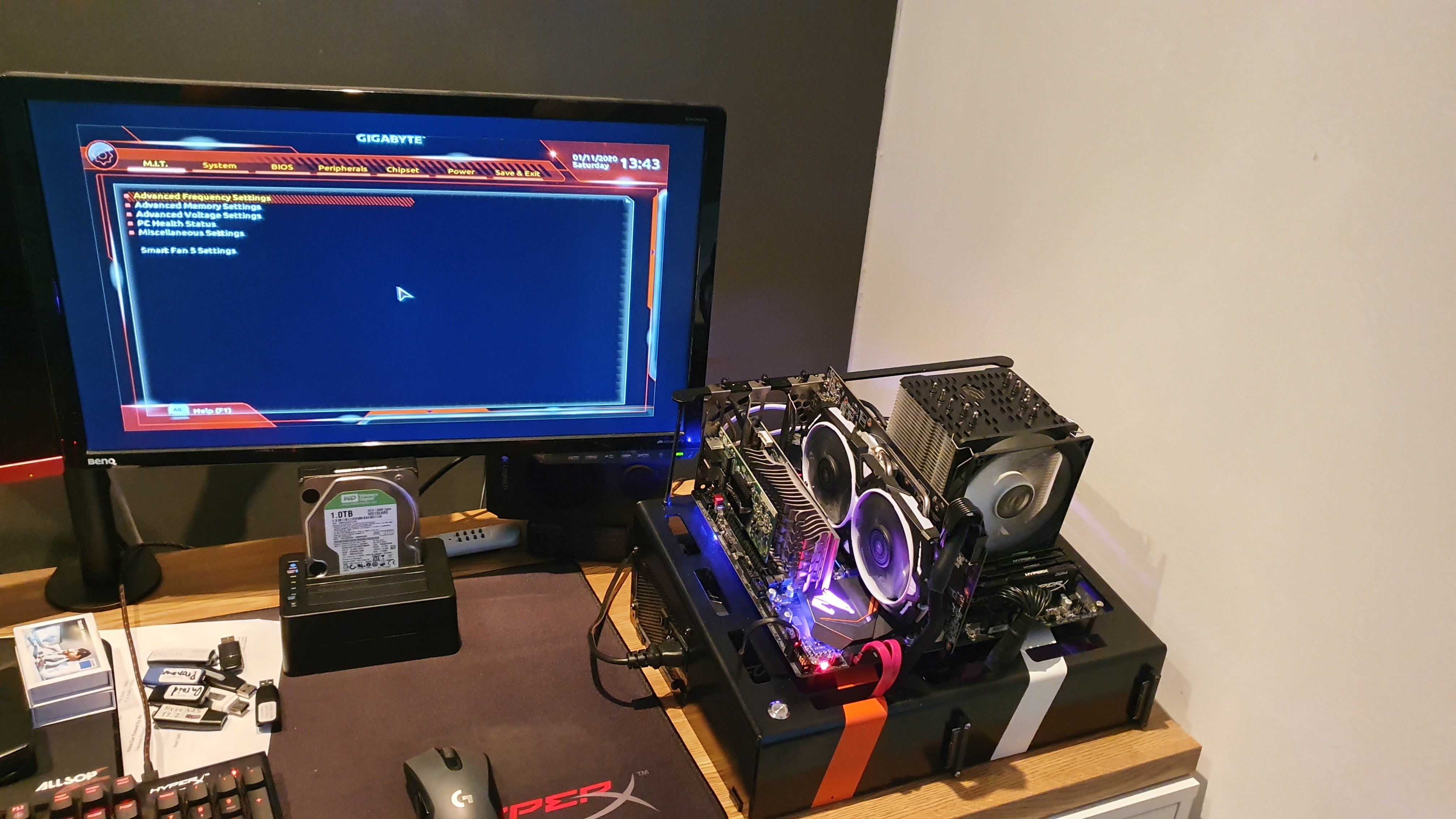

Throw the parts on test bench... RX580 in first 16x slot, GT520 in second and Pro1000/PT in last one. Seems like a nice setup, everything has room to breathe and managed to set GT520 as primary in bios. Time to update bios, make usb stick and get everything else ready. Hopefully next weekend I'll have the case to build, and start figuring out how to get drives and data from freenas without screw-ups. I have couple offline backups (wd green in the picture and another 1tb usb hdd) that are luckily still able to hold all of my most precious data so should be fine... :)
Could not wait, had to put some old extra hdd in, make array and see how the passthrough goes. So far we are looking good.
