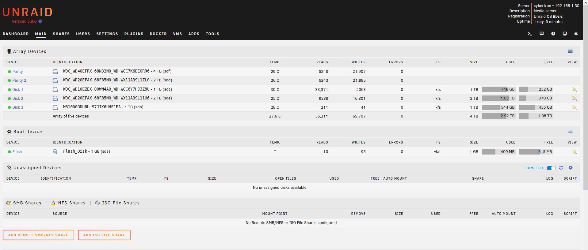

I recently added a second parity drive 4tb in size.  I was going to use the 4tb I added as well as the first parity drive I already had installed which is 2tb.  At first I did not realize that I would only be able to add disk drives up to 2tb in size, since that is my smallest parity drive.  I have another drive larger than 2tb that I would like to add to my array.  What is the best way to re-assign the 2tb drive and add it as a disk drive?  I recently found this article:  http://lime-technology.com/wiki/index.php?title=Shrink_array   Should I follow: The "Clear Drive Then Remove Drive" Method?  Please point me in the right direction, I appreciate the help.  Thank you.

It might save me a little time pouring over your syslog if you would post a screenshot of Main - Array Operation.

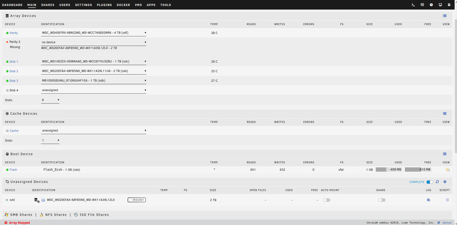

Well, I did add a second parity drive, but this wasn't the first time I added a new parity.  When I added the 2tb, it stayed in the parity 2 slot.  So when I added the 4tb I have now, it became Parity 1.  My plan changed a few times based on the drives I had available to me.  I bought more which is why I added the 4tb.
My goal is to have 1 parity with the 4TB.  Re-assign the 2TB Parity drive to a disk drive.  Remove the remaining 1TB disk drives, replace them with a 4TB and 2TB.
Here is a screenshot:
OK. Glad I didn't give you further instructions earlier then. You had been talking about "adding" drives. Now you are talking about "replacing" drives. Totally different concepts. And "removing" doesn't fit into the picture at all.
Adding means a new slot, removing means nothing remains in the slot.
Replacing means putting a different disk in a slot and letting Unraid rebuild it so it has the same data in that slot, but on a different disk.
If I understand correctly now, you want to replace disk1 with a new 4TB disk and replace disk3 with the disk that was assigned as parity2.
Is that right?
Yes, that is correct.  Sorry for the confusion.  I didn't give you the whole plan to begin with.

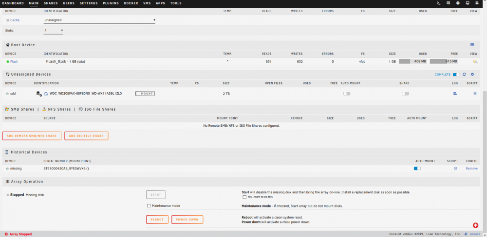

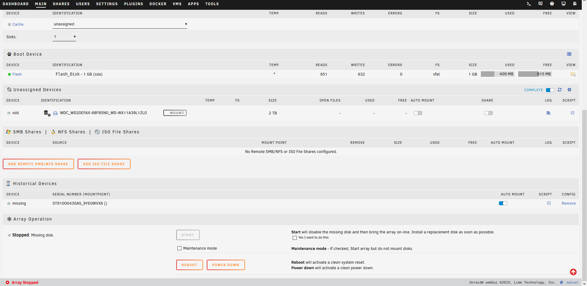

Do I want to disable the disk?  That is the only way it will allow me to start the array again after I unassign parity 2.
Edited by xNeRv3
Go to Tools - New Config. Keep all assignments as they are, except unassign parity2. Check the box saying parity is valid and start the array.
If you have any questions or something doesn't seem right, post a screenshot.
Thank you very much!  That seemed to do the trick.  I really appreciate your help with this.
