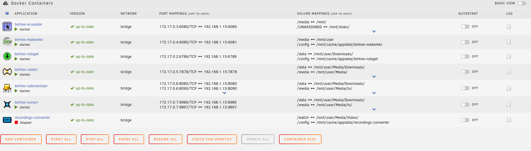

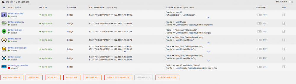

Here's a screenshot of my dockers, anything look strange?
2

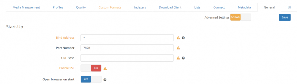

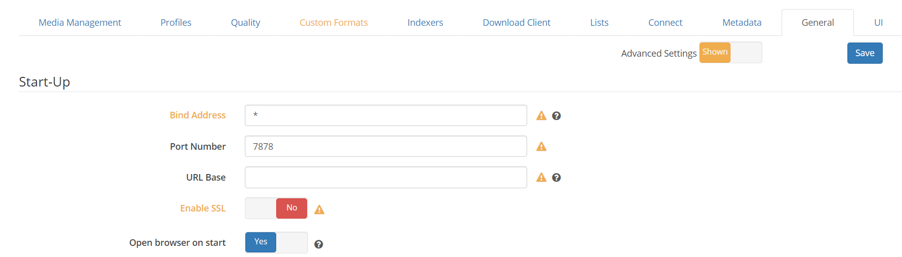

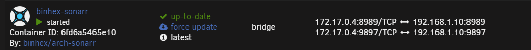

Looks odd to me, if that is in the sonar log it shouldn't be seeing the external IP 192.x.x.x
For example my logs only show:
19-12-22 17:55:09.7|Info|OwinHostController|Listening on the following URLs:
19-12-22 17:55:09.7|Info|OwinHostController|  http://*:8989/
19-12-22 17:55:10.7|Info|NancyBootstrapper|Starting Web Server
My docker config looks comparable
In the docker I just have this for the port
Edited by Decto
changed to advanced view
THANKYIU THANKYOU THANKYOU!!
Those screenshots and your confirmation of what SHOULD be in the logs sent me off to the 'hidden' general section of both sonarr and radarr where I found that I had bound  the IP address of my server  instead of '*' (or all interfaces). If anyone can explain just how this messed everything up I'd appreciate it. Once corrected everything sprang back to life. Can't remember when, or why, I made that change. A couple of months ago I think. But, can I again thankyou for taking the time to reply. Much appreciated!!!
