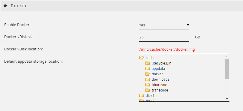

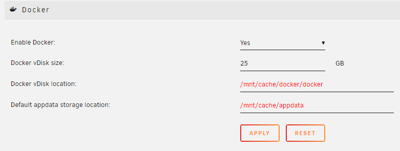

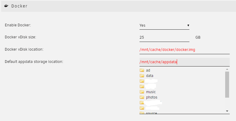

I stopped the Docker service to work on the network but now I can't get the docker to start again.  When I try to start it doesn't like the paths to the docker img and appdata directory.  They are on cache.  docker image path drop down shows cache then the docker folder.  The appdata dropdown doesn't show my cache directory.  Cache drive (500Gb SSD) is up, running, I can access it from the server CLI.

I still have issues with the docker service.  It won't start.  It doesn't seem able to find the paths for the docker.img (now deleted as part of last nights fault finding) nor the cache drive appdata directory.  In fact on the drive/share dropdown it doesn't even show cache anymore.

Something weird going on as you're missing the user0 mount point, try starting in safe mode.
I didn't try that but I managed to get it up and going by editing the docker.cfg file and changing "No" to "Yes".  Restarted the server and the docker service is running.
