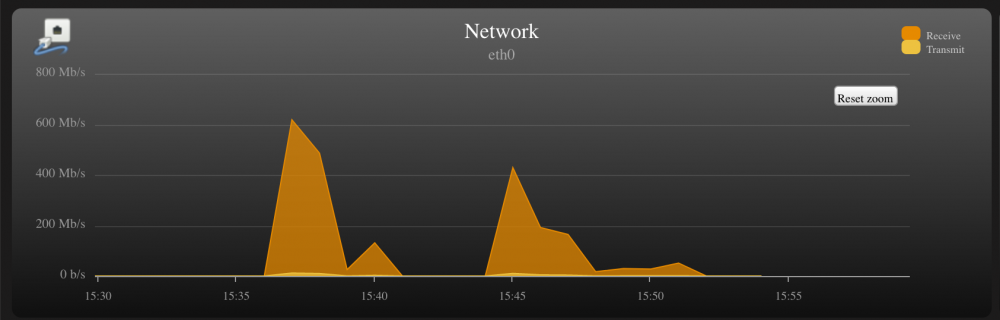

I'm new to unraid and am just setting up my first server and I've noticed as I am transfering files (anywhere from 20 to 100gigs at a go) to unraid the network performance for the first few gigs of data is "pretty good" ( approx. 888mbps) then drops for a bit, increases again then it drops and stays at 320mbps or less. I am wondering if this is due to my hardware limitations of the unraid server I have or there is some setting I should be using.  I have set the cache usage to be "yes" so that the cache drive fills first, then writes to the array (?) and am using encryption on the array drives (the CPU supports AES).
When I look at the dashboard, the memory utilization is low and the CPU load seems to be not particularly high overall. I did a search on the forum and haven't found a similar thread to mine (the ones I have found are talking about read performance). Thanks in advance and I apologize if this is a bit of a noob question.

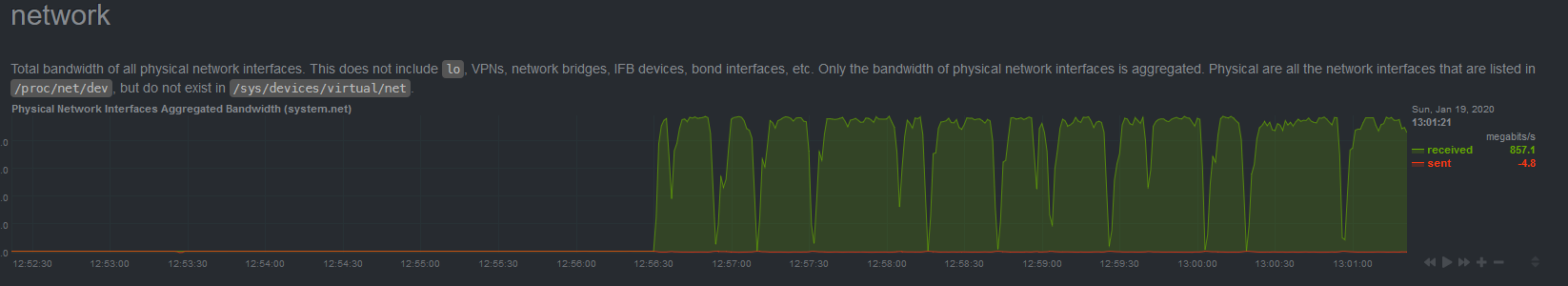

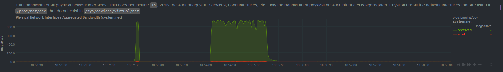

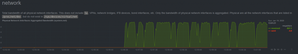

I've been struggling with this issue over the past month or two. I've recently started getting rapid drop-offs in write-speeds to my cache. When pulling down data from various servers (each able to upload at 250M/s) over my home gigabit connection I used to be able to sustain 100M/s ingest speeds as reported by rclone or a given desktop app, and that makes sense, given that I should be writing to my cache and thus bypassing parity. But as it stands (and for testing I've been pulling a single 10GB file at a time) I'll get 90-100M/s download speeds, sustain that for 3-6GB, and then rapidly drop to several M/s and ultimately get to a few kilobytes/second. After a few minutes of that the speeds with pick back up to ~60M/s, sustain for a few mins, and then drop back down. I rebooted my server a few days ago so don't have much historical data but I'm attaching a screenshot of transfer rates. I'm seeing this issue when using FileZilla on a Windows VM or using the rclone plugin running directly on unRAID. Any thoughts or suggestions? System stats and diags below.
Dual e5-2667 v1 (12 cores at 2.9GHz)
64GB memory
2-disk 1TB SSD cache pool
10gig NIC
Edit: added screencap of my rclone output (this is with turbo write on, though I don't think it should matter anyway since I tried writing to cache specifically) and a shot from NetData.
Edit edit: have isolated this to a cache-specific issue. When doing the same copy operation to an Unassigned Devices NVMe disk I can sustain 100MB/s write speeds. Next up is testing a write direct to the array, bypassing cache, with turbo-write turned on as described above.
