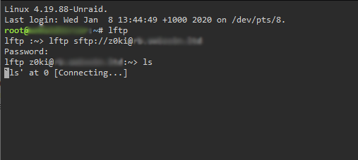

Hey guys I am wanting to use LFTP on my unRaid server so I can easily grab files from a seedbox. I downloaded LFTP from the NerdTools (lftp-4.8.4-x86_64-1.txz) so what happens now? I just assumed it'll be installed and I can open Terminal from my unRaid homepage type LFTP (hit enter) and login to my seedbox that way.
Sure enough LFTP shows up in terminal, and I can login to my server (so it seems) but when typing LS to view my directory it just sits at `ls' at 0 [Connecting...]
So maybe there is actual extra steps needed after grabbing LFTP from the NerdTools that I am now clear on?
Could someone please give me step by step instructions in 'laymens' terms for me please?

This part is unclear and makes me wonder how you are accessing "terminal" on your server.
Sorry I meant via the command terminal on unRaid's home page?
And in what way does LFTP "show up" there?
OK I see. I have not used that FTP before.
This is what happens. I did look at a number of posts on here about it but nothing concrete on how they got it to actually work.

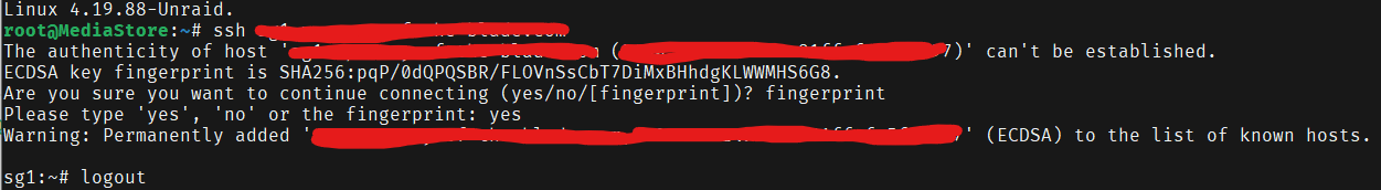

are you able to ssh to that server from unraid?
Hi @ken-ji
I just tested this and yes I can ssh into my seedbox via Terminal in unRaid.
When you ssh to your seedbox, do you keep getting prompted to save the fingerprint like above?
Because if lftp tries to connect to via sftp and a prompt about the fingerprint tries to show, the lftp session will get stuck.
you can try lftp -d sftp://.... command and see how the underlying ssh connection is having issues.

I only got prompted once to say key/fingerprint yes/no on my first attempted.
I just tried with lftp -d sftp:// and it worked! I can finally login via LFTP and browse all of my folders.
