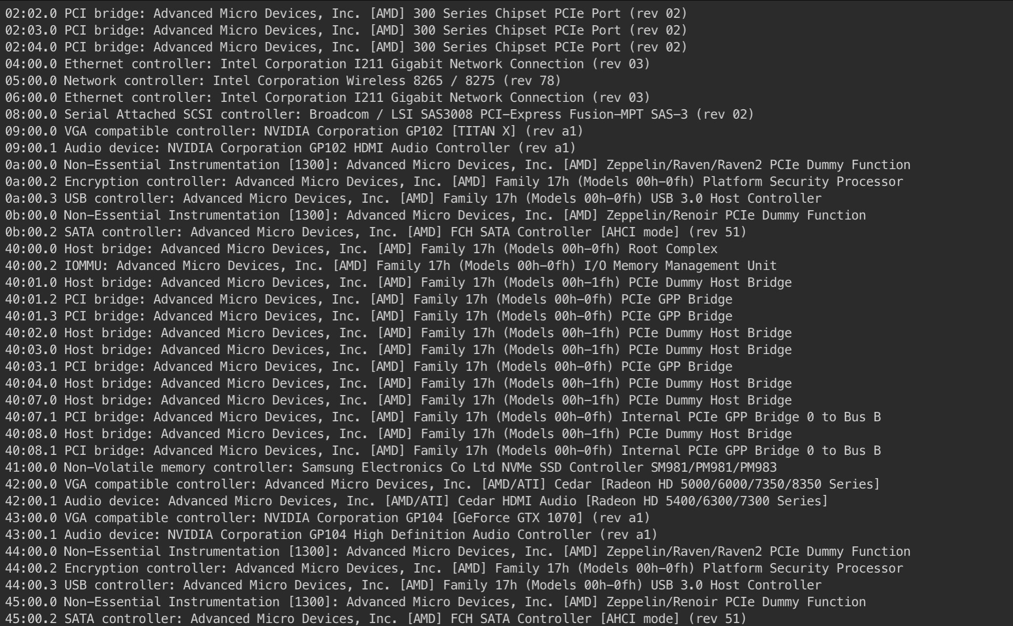

42:00.0, 42:00.1, 43:00.0, & 43:00.1 Aren’t detected in the system devices by Unraid, but are recognized at a lspci request from the terminal.  Example photo attached
