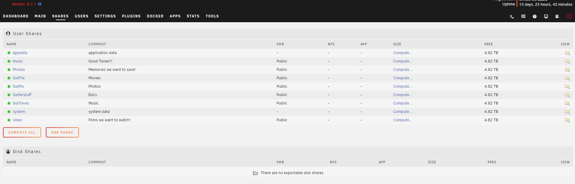

Post a screenshot of Shares - User Shares
Here is the screenshot
