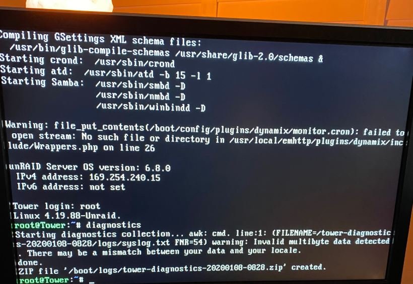

So I am stuck without able to do anything at the moment. I had trouble opening a few files last night, go to open my web-gui to see if everything was good today and tower/ doesn't load at all. and all my settings had been reverted, no dark mode, the default light theme etc. I stupidly REBOOTED.  I attach a monitor to my server to see what the issue was. No ipv6 to connect too.
I done some searching and editing the config seemed to be the go to, yet when I plug the USB (Kingston) into my machine, it was locked. and when I type diagnostics, it runs yet no file saves in my folder. Only previous diagnostics are there. I am guessing my USB is bricked? Would that explain why I had no ipv6 after reboot?

I will have screenshots somewhere, and I have copied the usb to my machine, I can read the info on it, just not edit it. Screenshot below is the last thing I can do. Does that mean it has saved a log somewhere? because when I go to where my previous ones are, this years 2020 current ones are not. My orginal problem was not having ipv6, or being able to logon onto the webgui.
