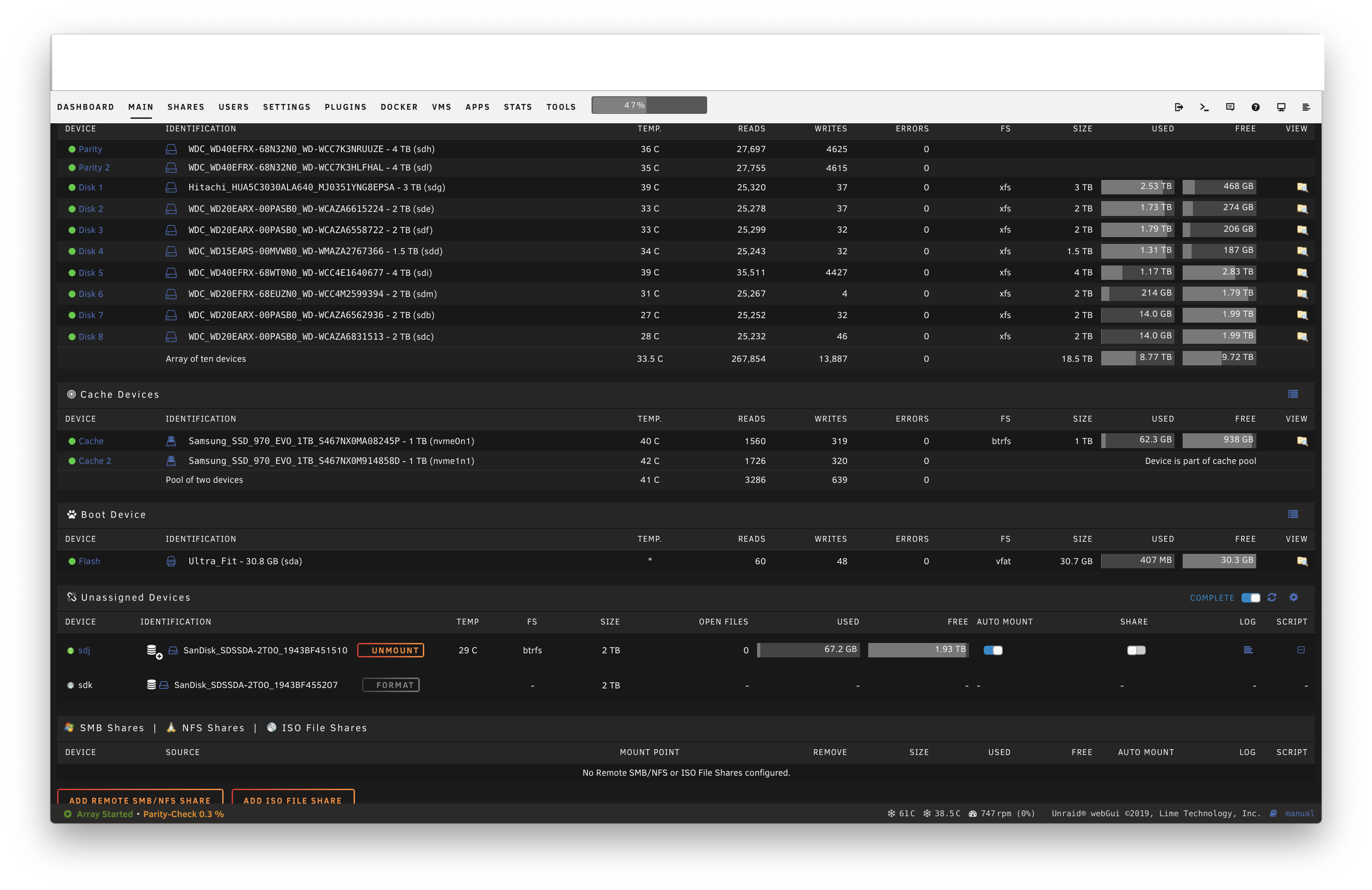

First of all, my disclaimer - I do not have much experience, having built UnRAID 6.8.0 system from scratch. The system goes systematically down (neither Web UI is responding, not docker containers and smb shares) and only hard reset helps. All the components are brand new. The configuration is as follows:
Fractal Design Node 804 - Corsair Rm850x, AMD Ryzen 3600, Noctua NH-D15s, 64Gb DDR4 3200Mhz Corsair Vengeance LPX RAM, AsRock X570m Pro, Zotac RTX 2070 Mini, 2x1Tb Samsung 970 Evo NVMe Cache, 2x2tb Raid 1 SSD as Unassigned devices, 10 HDDs with 2 Parities.
Initially I thought that I messed with plugins installation and some configs. Yesterday I reinstalled everything from scratch only keeping original network and array configuration files. Today the server is unreachable again.
I attach the lates diagnostics files I have. Will also try to get the latest file from today once I reach the server that is currently stuck and cannot be reached remotely again. Any advice and help is appreciated.
kk-server-diagnostics-20200107-2015.zip kk-server-diagnostics-20200107-1730.zip
Edited by andrey_kk

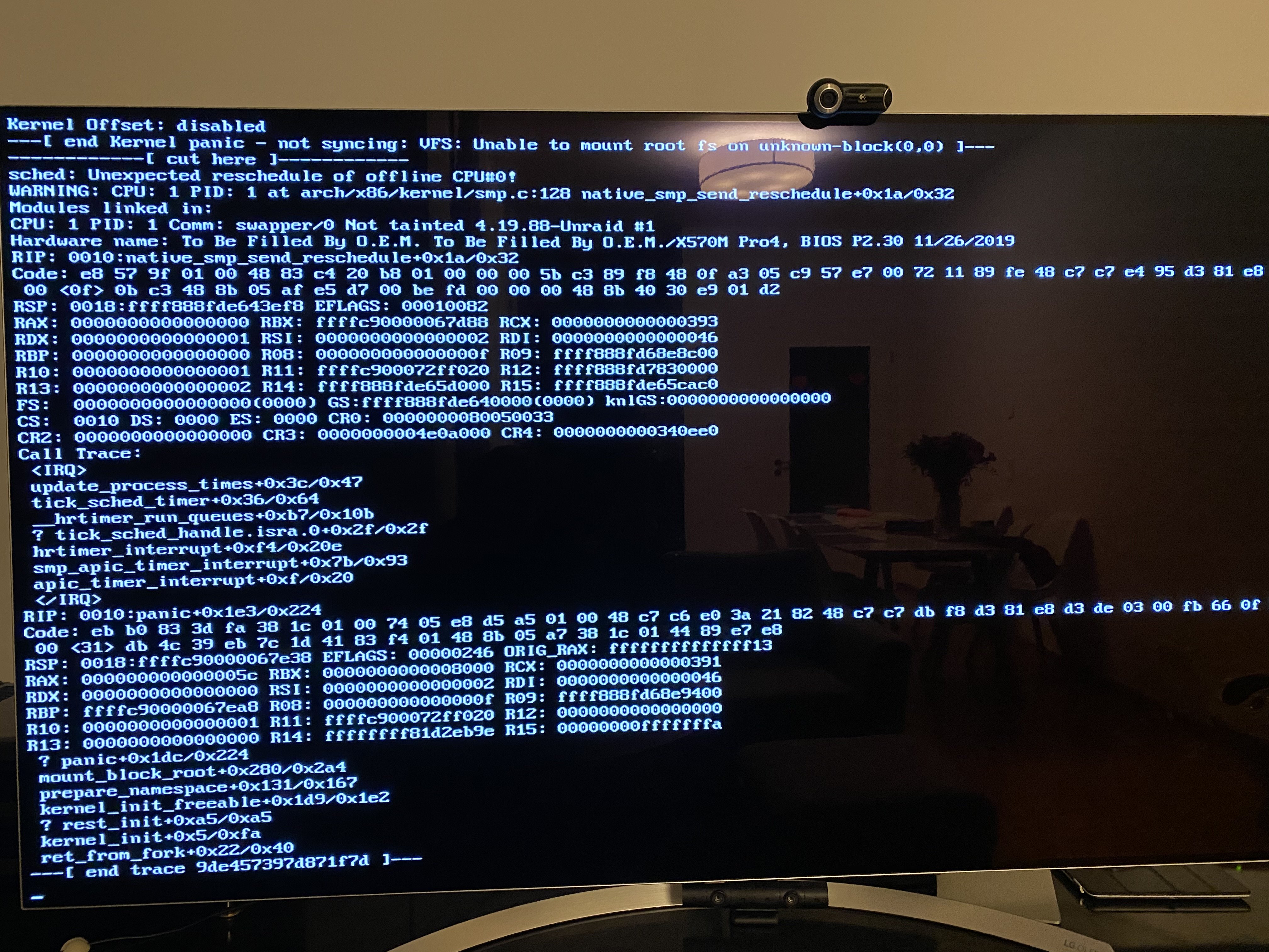

Thanks! Will try. Here is another screen shot after hard reset. It did not boot properly. Second hard reset helped. I also put "Global C-state..." option to enabled besides current already set to "typical". Will monitor.

There are multiple general protection errors, start by running memtest, also make sure RAM isn't overclocked, make sure you're respecting max support speed depending on system config:

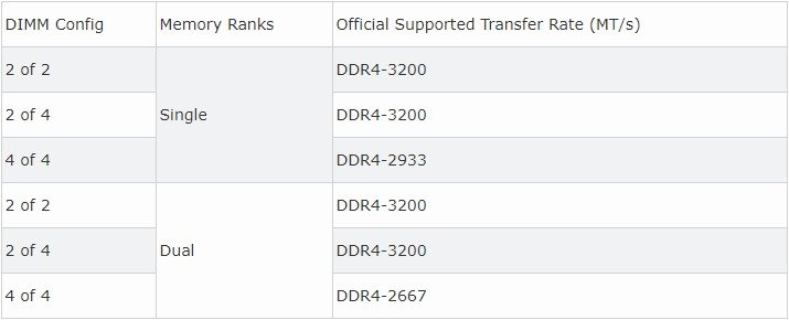

Thanks! Will do tonight. RAM is 4x16gb DDR4-3200 in stock XMP Profile. Will do memtest and try to find the ranking. Assume I definitely need to go down to 2993 or 2667 MHz. Will report accordingly.
Updated: report as promised- switched to Auto setting for memory, it turned to 2133 MHz. Since then now 14 hours uptime without any issues. Will monitor and report later again. Maybe will try to increase memory frequency a bit later within the allowed limits.
