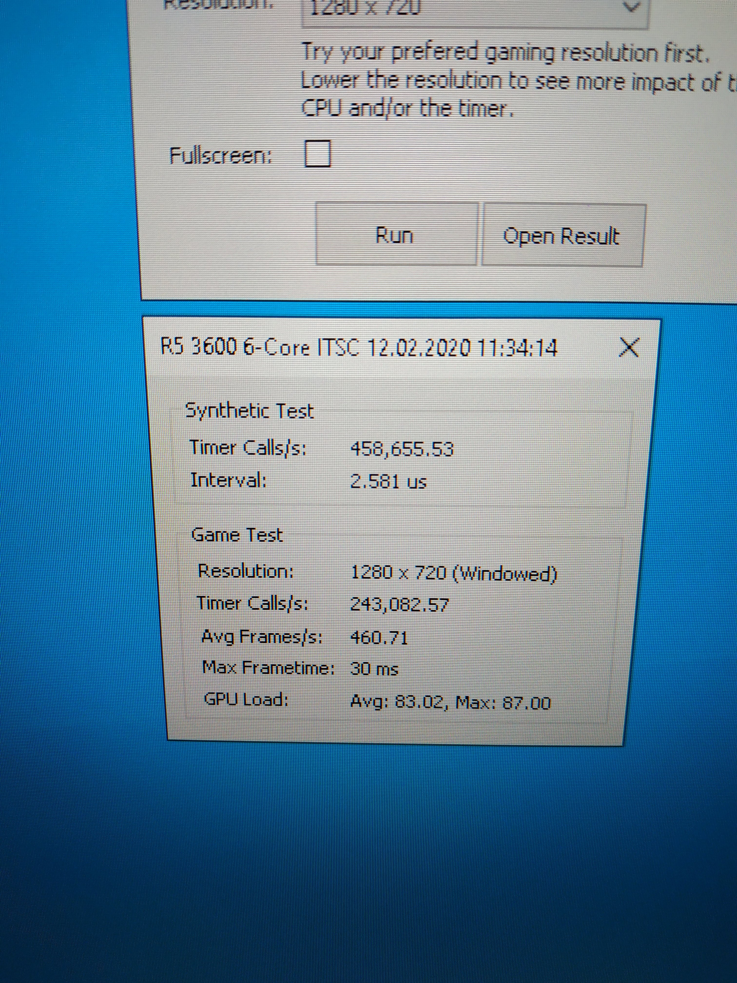

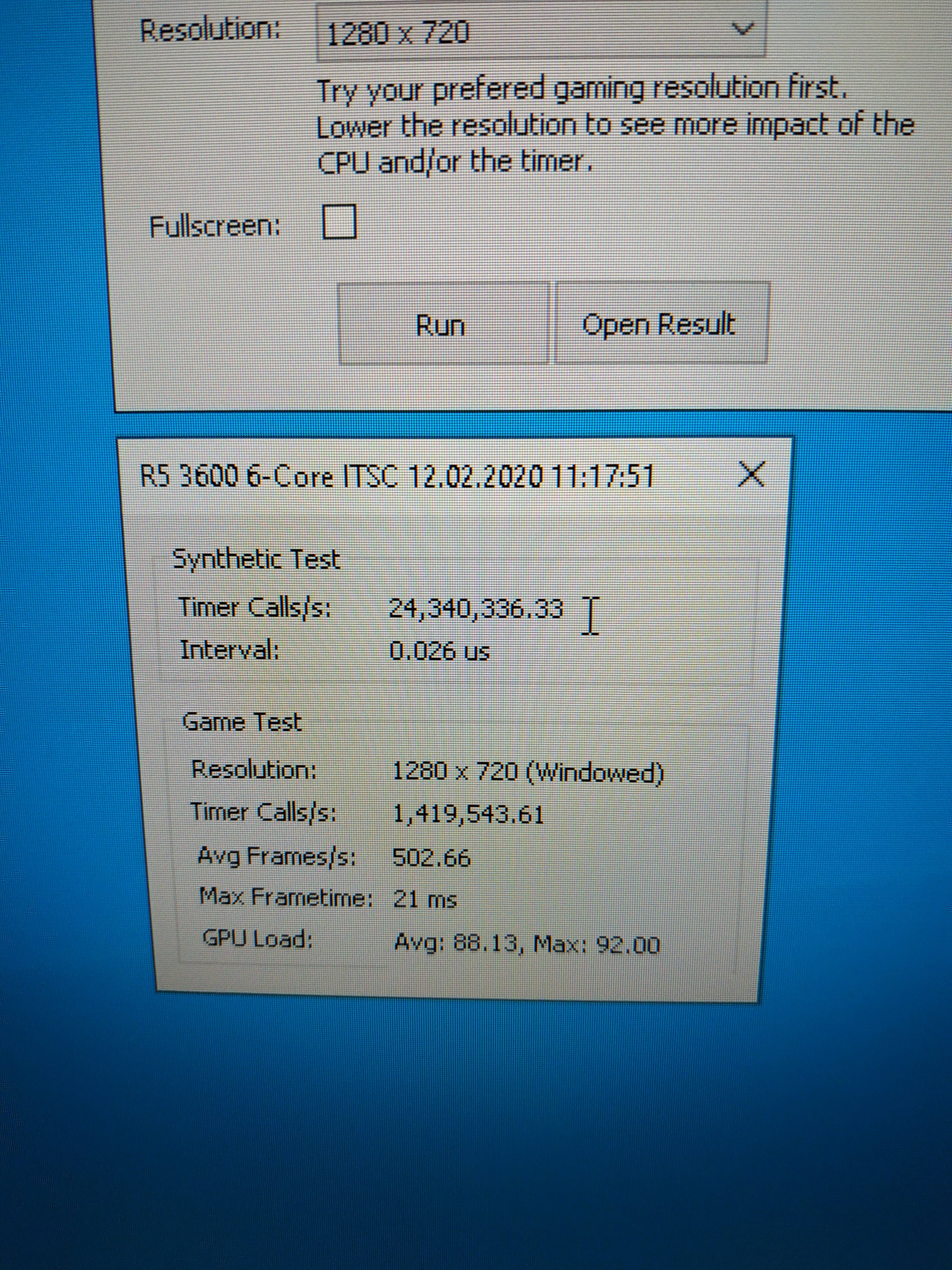

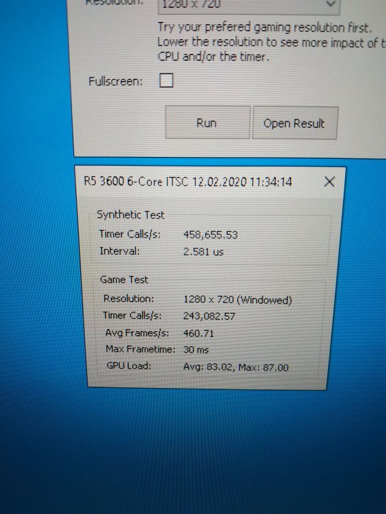

I've googled a timer benchmark TimerBench that is useful to test the Windows guest os timer performance. And it immediately shows the difference before and after:
IMG_20200212_113506.thumb.jpg.2a6601175d53ebb10200e7de84255a54.jpgIMG_20200212_112126.thumb.jpg.d233361f07a60bb3b960219b26607237.jpg
