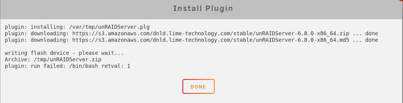

Update from 6.8.0-rc7 to 6.8.0 stable failed
Flash drive problems, run chkdsk on it.

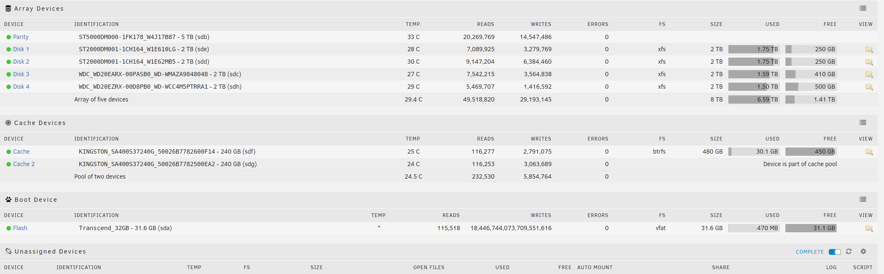

i have another question. Why dit it not notice the error?
on the screenshot it says 0 errors but the flash was already gone.
Errors column for cache and flash device are currently just for show, it works for array devices.
ok but i think it would be nice if it can send a email or so when the flash drive has read/write errors.
You can install the FCP plugin, it warns if flash goes read-only.
