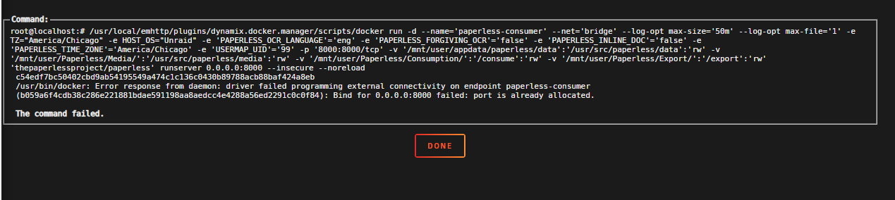

I got lost on step i think 4... with image.png.6138f2a5a35e6659e7b9e50819e6f4ab.png
I tried removing the port but it just adds it back in

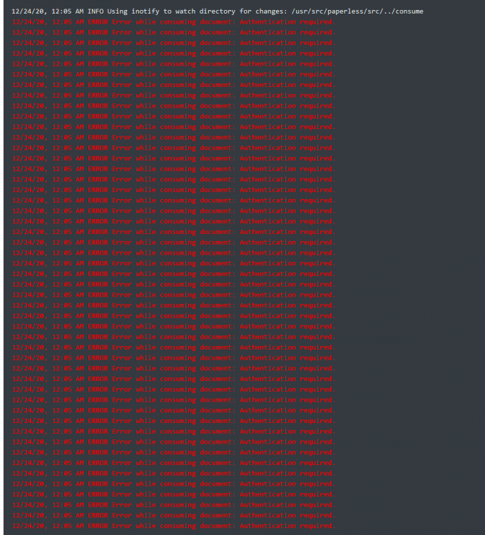

tried this but if i do so the container doesnt start. iam only get this error in the log:
