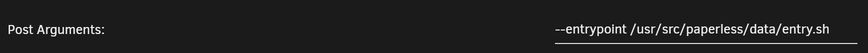

I'm having an issue getting the container to run with both webserver and consumer in one container using the script.  This is what shows in the container log:
Mapping UID and GID for paperless:paperless to 99:100
Operations to perform:
Apply all migrations: admin, auth, contenttypes, documents, reminders, sessions
Running migrations:
No migrations to apply.
Unknown command: '--entrypoint'
Type 'manage.py help' for usage.
I've got the script in Post Arguments:
I've also tried it in Extra Parameters to no avail.  Tried quotes also.  I've changed the script like @dcoens mentions above as well.  The script is executable as well.  Any ideas what I'm doing wrong here?
Looks like I figured it out and I don't get the error any longer.  It had to do with line endings.  For anyone else, the entrypoint needs to go into Extra Parameters.  I was getting the following error when I had it in Extra Parameters:
standard_init_linux.go:211: exec user process caused "no such file or directory"
I found this post:
https://forums.docker.com/t/standard-init-linux-go-175-exec-user-process-caused-no-such-file/20025/9
I created the file in VS Code, which I needed to change the End of Line Sequence from CRLF to LF.
