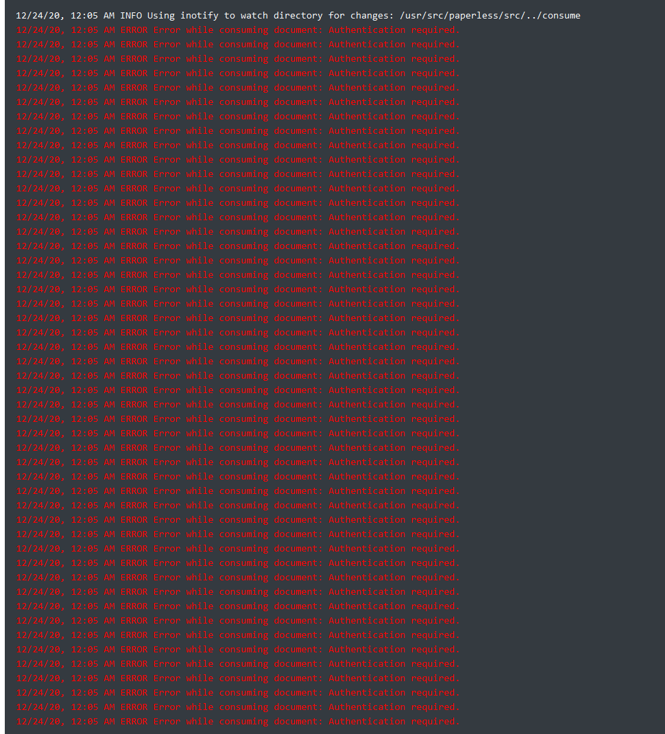

I was going through the logs and noticed that I was getting this error. i actually came from a fresh install of paperless-ng and I was wondering what step I might be missing because I can't seem to find where I would put the redis password. (assuming this is the authentication error the logs are eluding to)
Edited by jaychu
Please post your issue to the paperless-ng support thread. See my post: "Issues with the Unraid setup go here". This thread here is meant for issues with the original paperless docker container. My first case would be that your document is password protected. Further diagnostics in the other thread then.

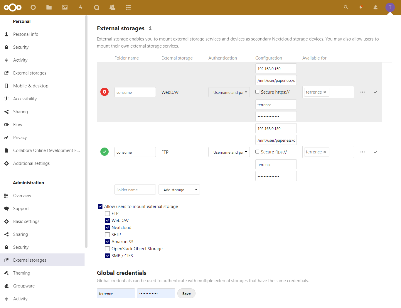

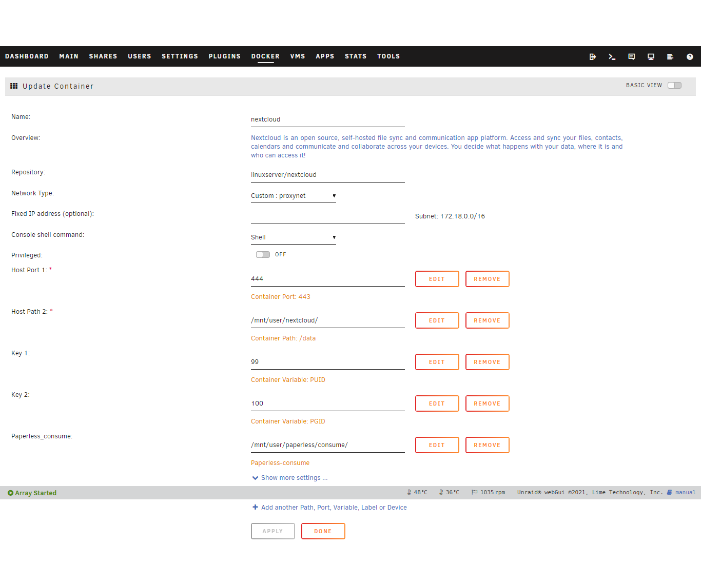

I am getting an error here. I think it is because I have not done step 1. What does it mean to mount the consume folder in the Nextcloud docker? How should I adjust the docker template? Should I use the user/pass for the unraid account? Should I use the local ip or outside domain?
/mnt/user/paperless/consume/  Is this the right format for the configuration I nextcloud external storage settings?
Thanks in advance.
P.S - I was able to get ftp to work, but my guess is WebDav is better.
2.1 WebDav Scan App with Nextcloud
I also want to share my scanning workflow with Paperless and Nextcloud (See https://blog.kilian.io/paperless/as reference). With the app ScannerPro, I can upload my scanned files to a Nextcloud folder via WebDav from my mobile device. This folder functions as Paperless consume folder and grabs the files and imports them to Paperless. Following steps required for the setup:
1. Mount the paperless /consume folder in the Nextcloud docker container via unRaids Docker template editor
2. Enable the external storage app as Nextcloud admin. The app can be found in the apps dropdown hidden in disabled apps.
3. Add the mounted consume/ folder as local storage for your Nextcloud user with name paperless-consume (Settings -> External Storage)
4. Configure the Nextcloud paperless-consume folder as WebDav target in your scan app
Edited by Profezor

Does anyone know how to get WebDav working please?
