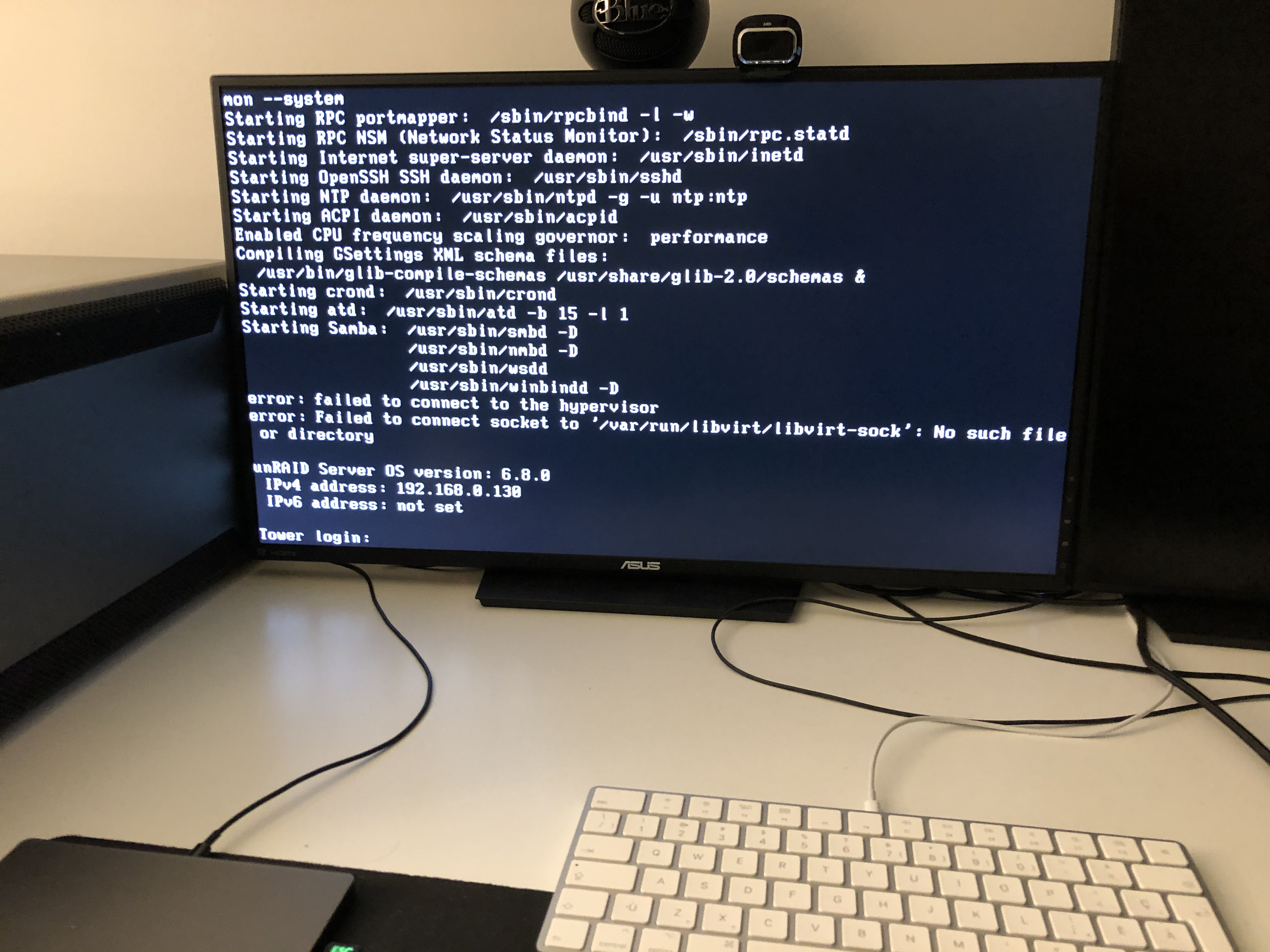

error: failed to connect to the hypervisor
I'm using Unraid version 6.8.0 as seen in the screenshot in attached.
Everything is working great, just fine actually !
I have an array and 2 VMs that start automatically.  Working fine !
I have noticed today that I get the following 2 errors during boot of Unraid that I never noticed before.  It doesn't seem to affect anything, but was curious if anyone could tell me why and how to fix it !
error: Failed to connect socket to '/var/run/libvirt/libvirt-sock': No such file or directory
Please see attached photo as for reference.
Any help would be greatly appreciated !
Edited by Ginfrecss
Same here.
Not sure if it is since 6.8.0, but when I boot in GUI mode the GUI won‘t show up and it stays in the command line as seen on the picture you have attached.
Does your Unraid Server behave the same when booting in GUI mode?

if you login at the prompt and use the df command does it show something mounted as /boot?
Same here, also after update to Unraid 6.8.1
But all my VM's runs well...
df tells:
/dev/sda1         30016160     605280   29410880   3% /boot
